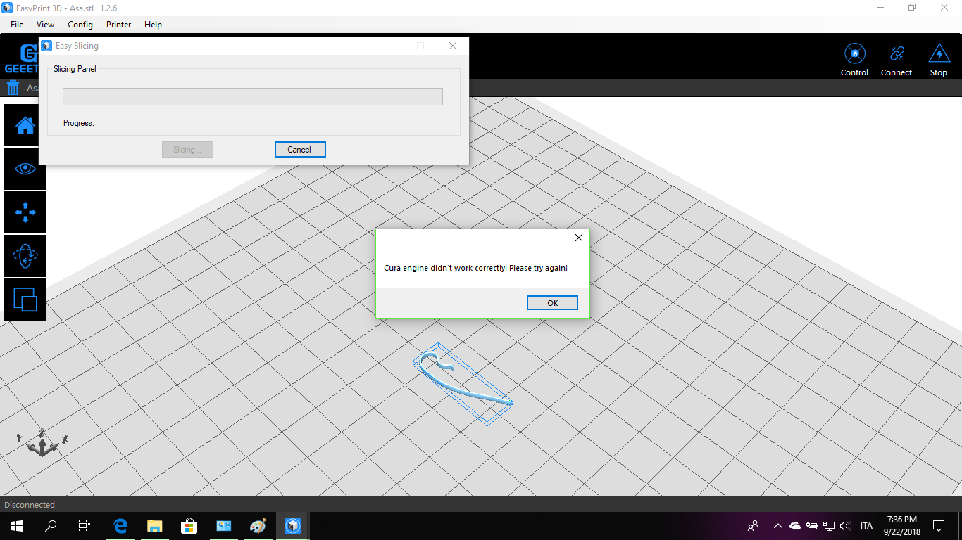

i have just installed Easyprint 1.2.6 to on a laptop with win 10 Enterprise
When I load an stl model and press the button Slicer the program complains with this message:
Any idea how to fix this error?
Best regards.

@KanKar
That would happened when Curaengine cannot generate the gcode file(So no gcode model can be showed in 3d view). Sometimes the engine setup failed but it works well most of the time.
Ok, you need to check if your engine working fine.
1. Open curaengine folder({Application Root}/Cura) and make sure CuraEngine.exe existed
2. Execute CuraEngine.exe in cmd.exe(windows command line) and check the output :geek:

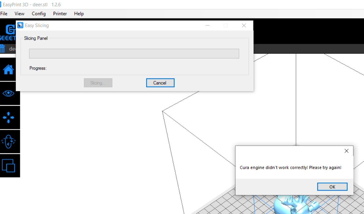

i'm having the exact same issue, here is the output of 'curaengine.exe'

@Gravitys
Looks like your engine works fine. How often did you meet that situation?

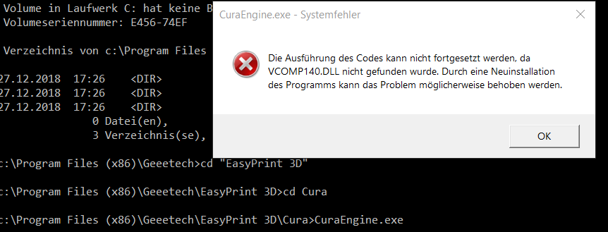

KanKar wrote: Sun Sep 23, 2018 1:45 am Hi all,
Best regards.
I have the same Problem (win 10, Easyprint 1.2.6), curaengine complains about missing VCOMP140.DLL. I think it is a dll from Visual C++, but I did a 'complete' Installation of EasyPrint already. can someone help me?
The attachment 2.PNG is no longer available
bertie
Posts: 6
Joined: Fri Dec 28, 2018 12:42 am
Re: Easyprint software for WINDOWS
Post by bertie »
I solved it by manually downloading and installing Visual C++ Redistributable 2015 (X86 + X64) from Microsofts website and reinstalling EasyPrint. Installing C++ via EasyPrint installer did not work for me and on my machine was only version 2017 instead of 2015.
