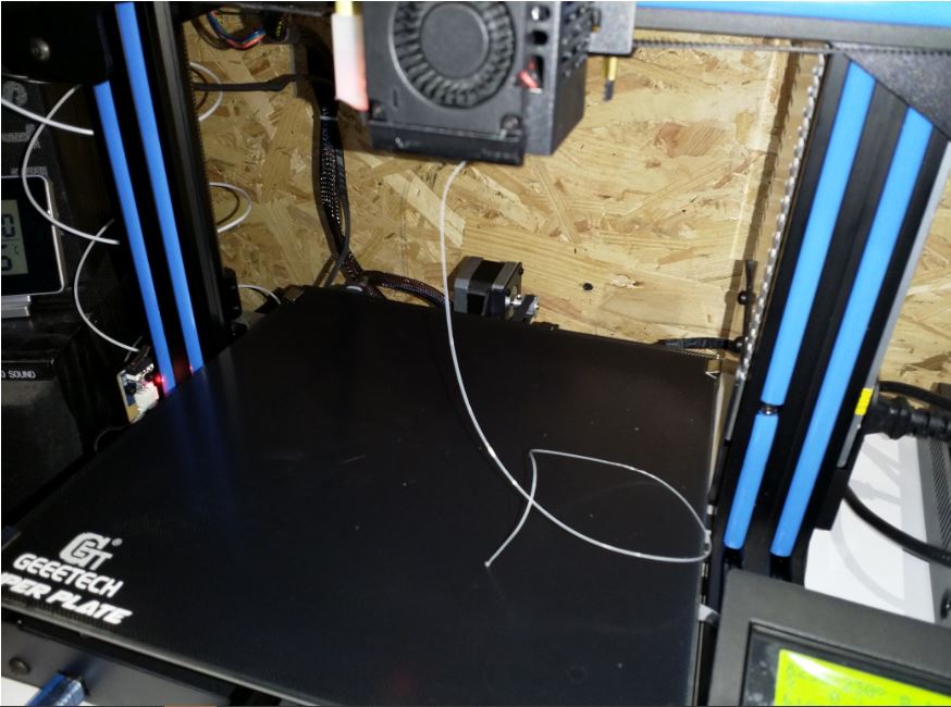

Sorry I ended up super busy last night. Tonight after I get back home from shopping, around 6:30 pm US CDT. I will make a quick video of what I have found with my A10M and my Creality Ender 3 on the extruder. I hope that it will. Also without the nozzle in force by hand some filament through. I had an ABS blockage once and didn't know it till I stripped some PLA in my extruder. Also I have been heating up to 250 on the hot end to clear blockages. You said that the filament was not very fluid. Could you show me a picture of 50 mm of filament pushed through the hot end at 210?

Looking forward to see your video, as you asked i take a picture and here what is look like.
After this i give a another chance to print a usb holder but nothing comes out from extractor as you can see on video.
https://www.youtube.com/watch?v=XH4spvk6f4o
- 50mm.JPG (85.58 KiB) Viewed 17869 times
