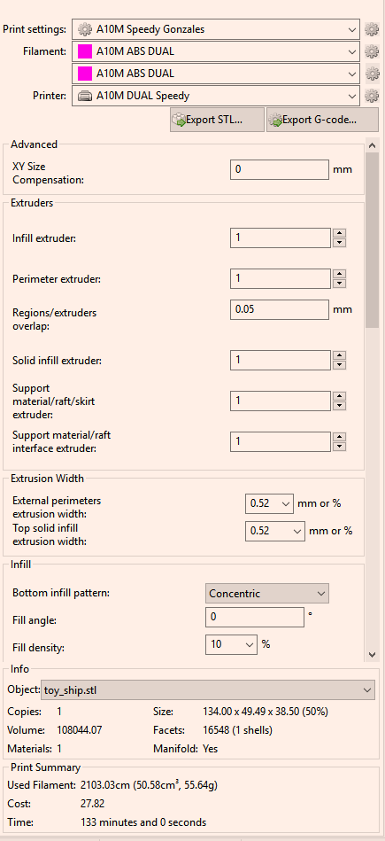

Dual color printing fixed error with retract, more refinements
How to do with dual colors:

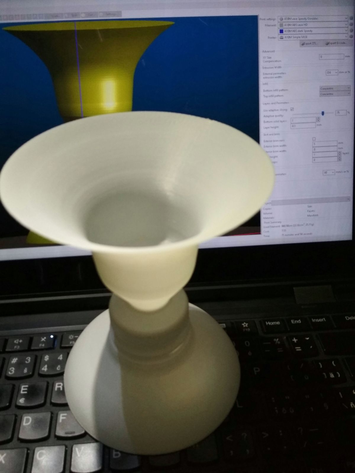

minor updates and wayback some vase settings.
This vase is resized to 133mm height https://www.thingiverse.com/thing:2838942 and is here in gcode and photo with settings

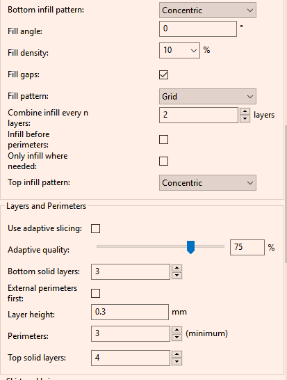

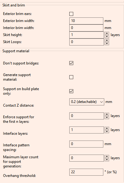

Slic3r A10M 3D printer profile
Also on GITHUB: https://github.com/Jardal/A10M-Slic3r-profile
Included example of dual color print without bucket and without tower
This is content of the folder and file structure from c:\Users\[yourname]\AppData\Roaming\Slic3r
This profile is for genuine Slic3r.org slicer development version only, which you can download it here: https://dl.slic3r.org/dev/win/
Note that Slic3r need a lot of power to display itself, it will display slowly on machines with Atom or similar CPU.
**All settings are for UNTOUCHED printer as you got it from manufacturer.**
All values are calculated to 340 extruder steps as in A10M factory firmware. If you have calibrated values or use 430 steps, set it to factory values.
Printing speed is limited by volumetric speed to 10mm3/s. Physical limit of path extruder gear - hotend tip is about 13-15mm3/s. Because my extruder lever is broken after few weeks, I was print another and use bigger spring. Your gears should be clean, no splinters from filament, only small amount of white dust at both sides of saw wheel and filament way is mirrorish clean.
There is unique **implemented height-temperature response** which is good for free-air printing. I was discovered right values while printing of skewed vase mode complex models. But result is not as strong as high temperature prints.
## Slicer picked options
#### Advanced
- Infill/perimeter overlap - if your long bridge hairs are falling from edges, use bigger value
- XY Size Compensation - compensation if you need to fit together (0.05mm mean 0.2mm difference in tolerance of joined diameters)
#### Extruders
options for dual material or color prints only
#### Extrusion width
Use both values to fit your design or use "auto" value together with Fill gaps option checked.
#### Infill
- Infill patterns - Hilbert is for great adhesivity of bottom side. Other use as you want.
- FIll angle set to 90 if you want different bridge or top layer way.
- Fill density - use bigger values to make it strength
- FIll gaps - worse print quality, better strength
- Combine Infill - for speed-up prints
- Infill before perimeters - use it if you need as much exact size of diameters or when infill destroy perimeters (ABS); use low infill only (10%)
- Only infill where needed - unchecked is for strong prints, checked acts as internal support material
- Solid infill treshold - about 5-10 for strong vertical sticks, 0 for selected % infill only.
- Solid infill every - is for better strength
#### Layers
- Use adaptive slicing - for models with many skews, Quality 75% is good for many details, 35% is good few details
- Avoid crossing - if on, then printing quality of small details is much worse, leave it off (maybe disappear in future - future is now)
- External perimeters First - if you want to have as much exact surfaces as possible.
- Only retract when... - disable it in rare case of simple objects or if you print infill only without perimeters (aka negative vase mode), enabled for spedd-up print

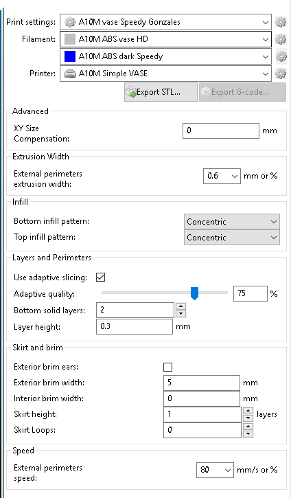

## Vase mode prints guide
#### Print settings
- vase HQ for highest quality of print
- vase Speedy Gonzales is fast print
- Vase Paper-thin - if you need paperweight vase mode figures
#### Filament
- vase HD - for high details prints
- vase BLACK - for asphaltic black colour only
- Light Speedy - for all other colours - if it does high-temp artifacts, use dDark Speedy or Dark only.
#### Printer
- Simple Vase for simple vase models without retractions
- Strong if object is not slashed
- HQ/Speedy if vase is relative complex object with needed retractions
## Dual colour print configuration
For bucket and switching filaments (no mixing at the moment)
- Print: HQ/Speed
- Filament: DUAL
- Printer: DUAL
#### Advanced
#### Extruders
#### Infill
#### Layers
#### Speed
- bigger speed = worse detail, worse adhesivity
#### Print settings
#### Filament
#### Printer
- Print: HQ/Speed
- Filament: DUAL
- Printer: DUAL

- Support is needed only in rare case, adaptive mode prints from about 10 deg withut it.
