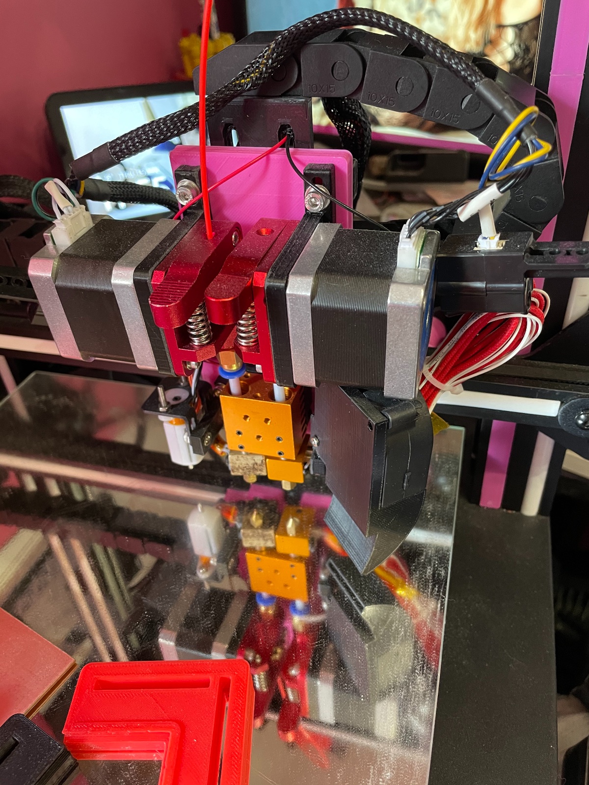

It’ll be interesting to see what you come up with. I’m constantly thinking of upgrading parts, and I’m now looking into using 2 V6 hotend on a swivel to move the nozzles away to avoid crashing and oozing. I’m also looking at a dual extruded setup using a single stepper. I’ve attached a pic of my current chimera mount, with swing away parts fan for access to the grub screws which also gets the nozzle out of the heat if I’m running with the fan off. If I keep this design then I still have the filament detectors to mount, time will tell.
I’m in the process of making mounts for the GTR boards and the TFT43 display, so until that’s all installed and configured the chimera is being used as a single nozzle hotend (hence the shiny heat block)
Keep us informed on progress for your design, it’s interesting to see how others develop things.

Abi_Jen
Posts: 5
Joined: Tue Jan 26, 2021 8:22 am
Re: GT2560 V4.0 motherboard wiring diagram
Post by Abi_Jen »
hun46y3 wrote: Thu Apr 22, 2021 10:13 pm Hello there!
I'm fighting the clone chimera hotend mounting as well.
I have the same exact problem, the screws for adjusting the heating blocks are on the back and are not accessible.
Is your adapter design available?
It would be a great help!
Thanks in advance!
I just uploaded my files to Thingiverse so you can see what I've put together. https://www.thingiverse.com/thing:4848050. The Fusion 360 working file is included for you to tweak/edit as you need. If you reupload, please give credit or list as a remix of my work. There's some minor issues I'd fix which i've noted in the Thingiverse (extensive) description, but since i'm contemplating a change in my setup to dual V6 hotends I probably wont do any further work on this as it works well enough for my purposes as it is.
I hope this helps someone get their chimera clone fitted and working for them.
Good luck,
Abi.
