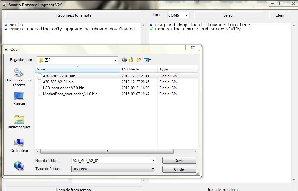

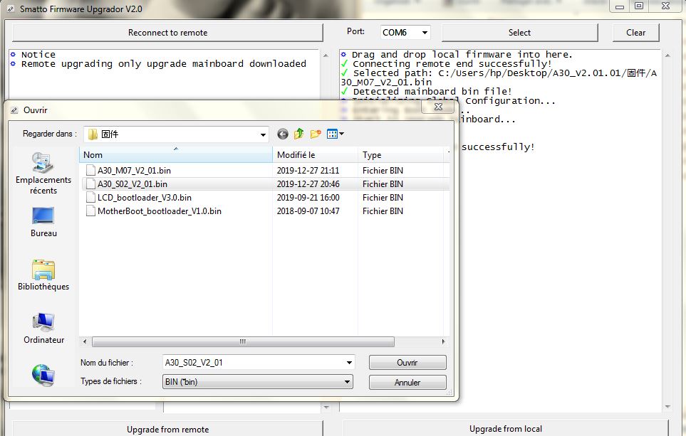

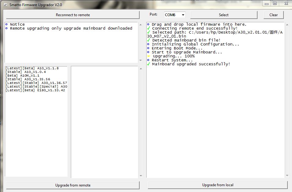

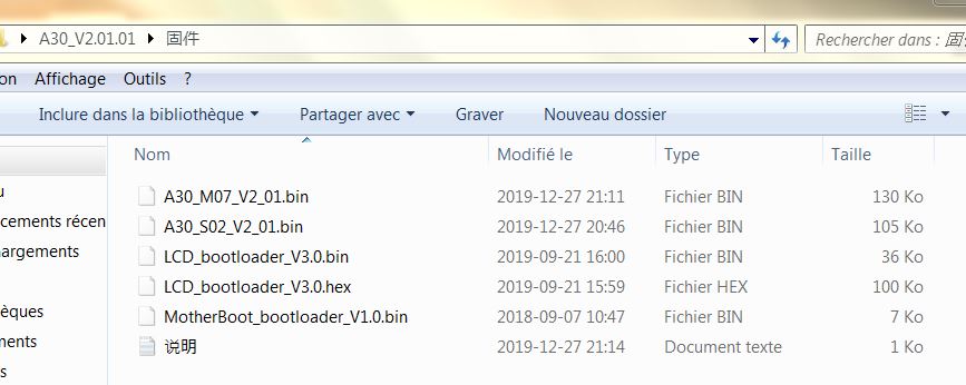

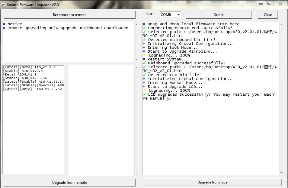

Re: LCD display problem
Hi
i udpate the firmware of mainboard then lcd successfully. the lcd screen still black.the 2 leds on the back of lcd is light on.
i copied the UI on sd card then insered in the lcd slot. nothing heppened, the screen still black.
i can't see if the lcd screen downloaded because it's black
what can i do ?
Hi,the firmware did not update successfully.
You need to copy the file(A30_M07_V2_01) to the desktop and then drag it into the firmware burning tool.
Direct drag may cause file recognition errors.
Hi William
Did you see the update pictures ? i did the update with smatto firmware upgrador V2.0
i don't understand,
you meen i must copy the file(A30_M07_V2_01bin ) to the desktop, them i click select in the firmware upgrador , then, upgrade from local ?
what about the file (A30 S02 V2 01bin , i do the same thing ?
