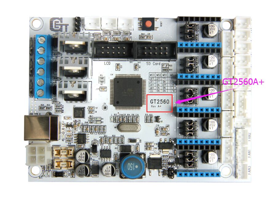

Hi, first of all thanks for your support. This is my first post. I'm going mad with 3d touch sensor, i compiled the firmware by myself because i didn't see you post at that time, now I've would like to test your. I have stupid proble, how do I recognize if my board is the old one or the A+ version?
Thanks again!
Re: 3D Touch Sensor:Auto-levelling for Geeetech 3D printer
The board has a name.
