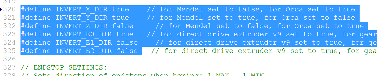

thanx again but i tried easyprint 3d 1.1.7, updated the firmware in the program but same thing is happening. every time i turn on the printer or connect a usb the motors are struggling to move when i choose "auto home". i have to go to "control->Restore Failsafe" every time i turn on or plug in a usb just to get it to move correctly.
Re: Firmware for geeetech 3D printers
You can change value of the direction of motors and then upload it to the printer

you have lost me?? i havent got a clue how to do that or what you are on about?
im just going to send this thing back, get my money back and save up for an Original prusa. i bet they dont turn their back as soon as you purchase a product!
