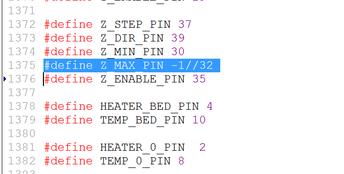

still not working :-(
My pin.h file does not have the settings in so I updated the settings in the pins_ULTIMAKER.h file. my pin file contents are

#define Y_ENABLE_PIN 29
#define Z_STEP_PIN 37
#define Z_DIR_PIN 39
#define Z_MIN_PIN 30
#define Z_MAX_PIN -1//32

Help! I've purchased a BLTouch from Geeetech and am trying to install it on my i3 X Pro (with GT2560 Rev A+ board).
I've wired it up correctly, and it lights up and does the couple of test lowers/raises when I power on. I've made all the changes to the firmware and uploaded that. The light does come on when I push the pin up, and goes off when I pull it down. The M280 P0 S10/90/120/160 commands don't do anything, and M119 is showing Z_MIN always "open" (If I disconnect the wires from the BLTouch, then Z_MIN changes to "TRIGGERED". If I then touch those two wires together it will switch to open), so it's not a wiring issue.
Any ideas what could be wrong?
In the configuration.h I setup the following:
#define ENABLE_AUTO_BED_LEVELLING
#define AUTO_BED_LEVELLING_GRID
left/right/back/front - all defined ok
G29 moves to the various positions and tries to test (but grinds into the bed because of the Z_MIN issue)
in pins.h (under the Ultimaker section):
#define SERVO0_PIN 11 (as I'm using the 2560 A+ board)
Any ideas?
Re: 3D Touch Sensor:Auto-levelling for Geeetech 3D printer
You can refer to this line
