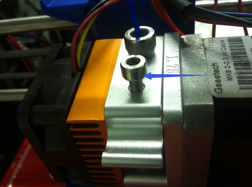

Try to adjust the intensity of extruding by the thread.

Post by buzmal »
I Have adjusted that screw. if it is lose then the gear slips after teh extruder blocks, if i tighten it the the motor jitters.
