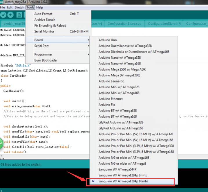

Hi,I think the board setting in Arduino is wrong,it should be set like the attachments showing.You can check more detail in the following link:http://www.geeetech.com/forum/viewtopic ... 20&t=16433.tzupi wrote:I have the very same problem.

- 1.png (308.56 KiB) Viewed 35423 times

Thanks for the answer! I was not clear but I had that board chosen.
Although fortunately I found the solution and I will write it down to here for anyone. It would spare a couple of hours of googling.
1. Error during the compile : using typedef-name 'fpos_t' after 'struct'
Use Arduino 1.0.1, because the newest versions have different command set and Geeetech use the old one.
You can find it on the Arduino page
2. Again an error during the compile : #error Oops! Make sure you have 'Sanguino' selected from the 'Tools -> Boards' menu.
Download the Sanguino addon the Arduino from here : https://github.com/Lauszus/Sanguino
Locate your sketch folder : you can find it in the settings where it is exactly (user/Documents/Arduino on OSX, something similar on Windows 10)
Copy the Sanguino folder to there. After that you will see the "Sanguino W/ ATmega1284 or ATmega1284P (16MHz)" in the board list, and that is what you will need.
3. After compile, it pause a while before uploading then drops that error : avrdude: stk500_recv(): programmer is not responding
Locate the boards.txt in the Sanguino folder and edit it. Search for the Sanguino W/ ATmega1284 or ATmega1284P (16MHz),
and change its baud settings. It was 115200 for me originally. Set to 57600 than the uploading was successful.
