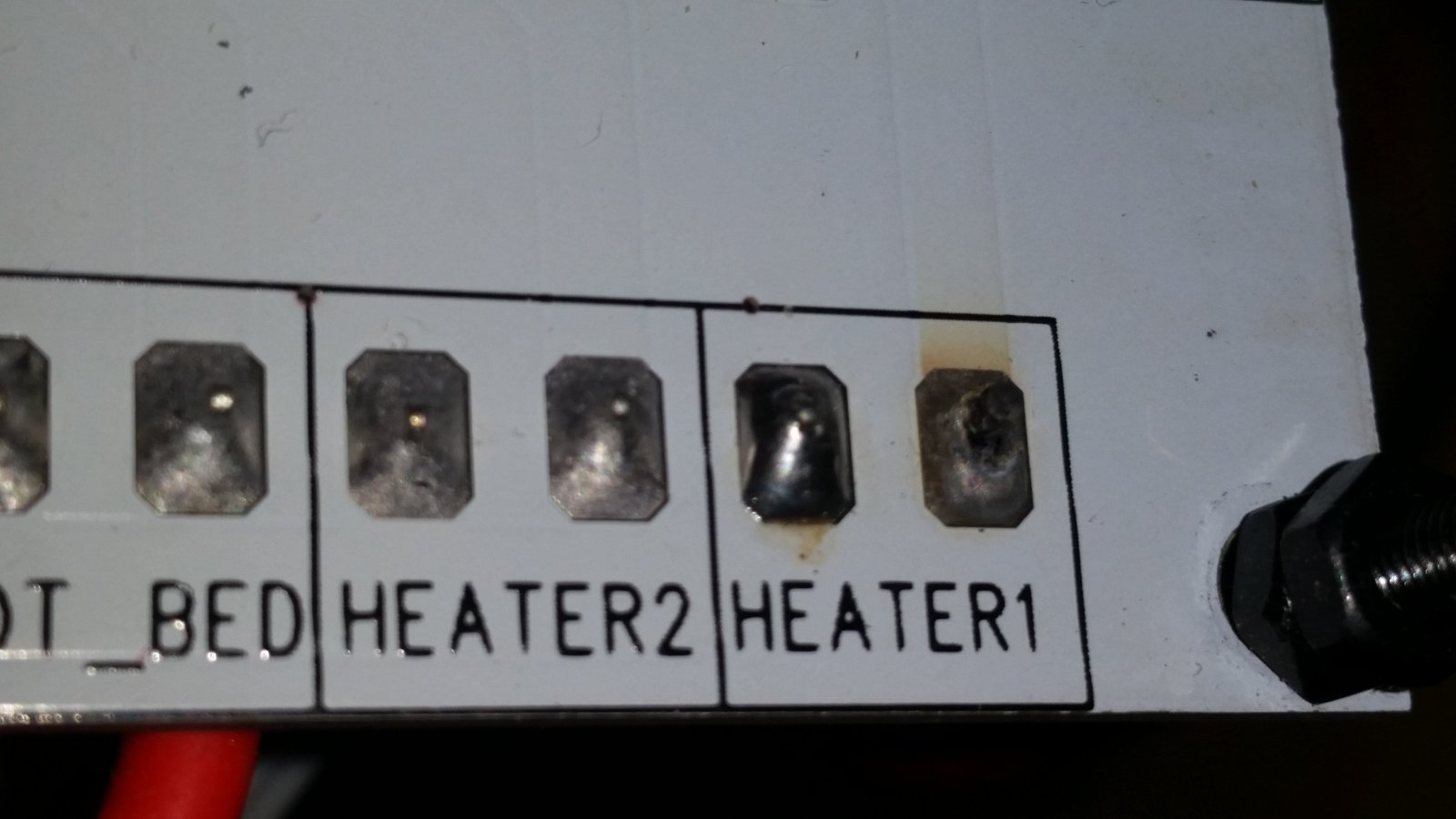

Hey printer-folks,
I've got a similar problem that the heater was not heating up despite the fact that MOSFET, fuse, LEDs etc. all were OK. There were no 12V on the pins of the hot-end heater while the bed was working fine.
When unmounting the board (GT2560) I discovered this:
Re-soldered the PIN and got 12V again. First test-print prints since 5min. without problems.
Now, my question is wheter this was just due to bad soldering or is it maybe a symptom of a bigger problem in the setup? Maybe a short-circuit in the heating-element (actually I have changed it some 20 printing hours back)?
