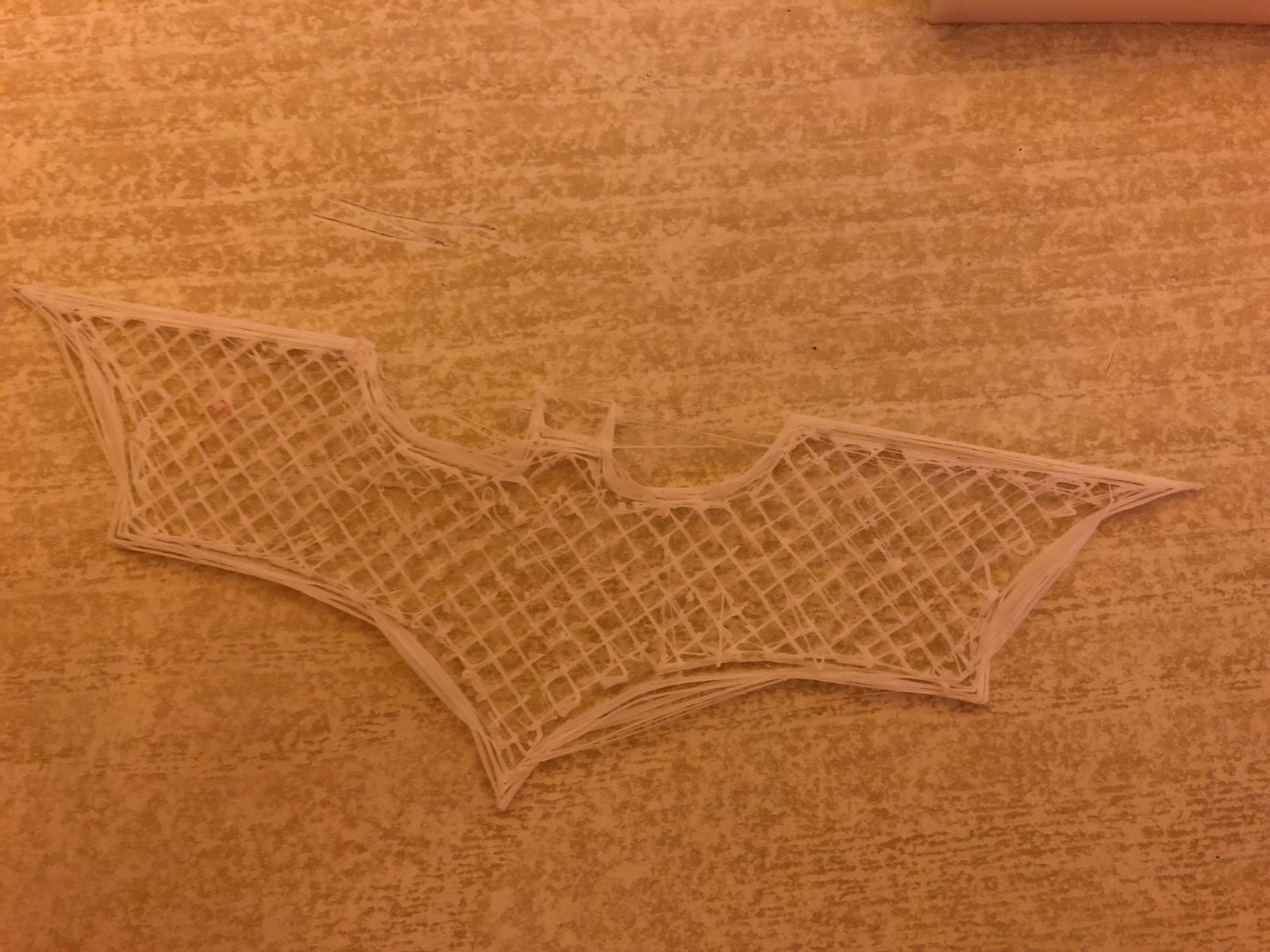

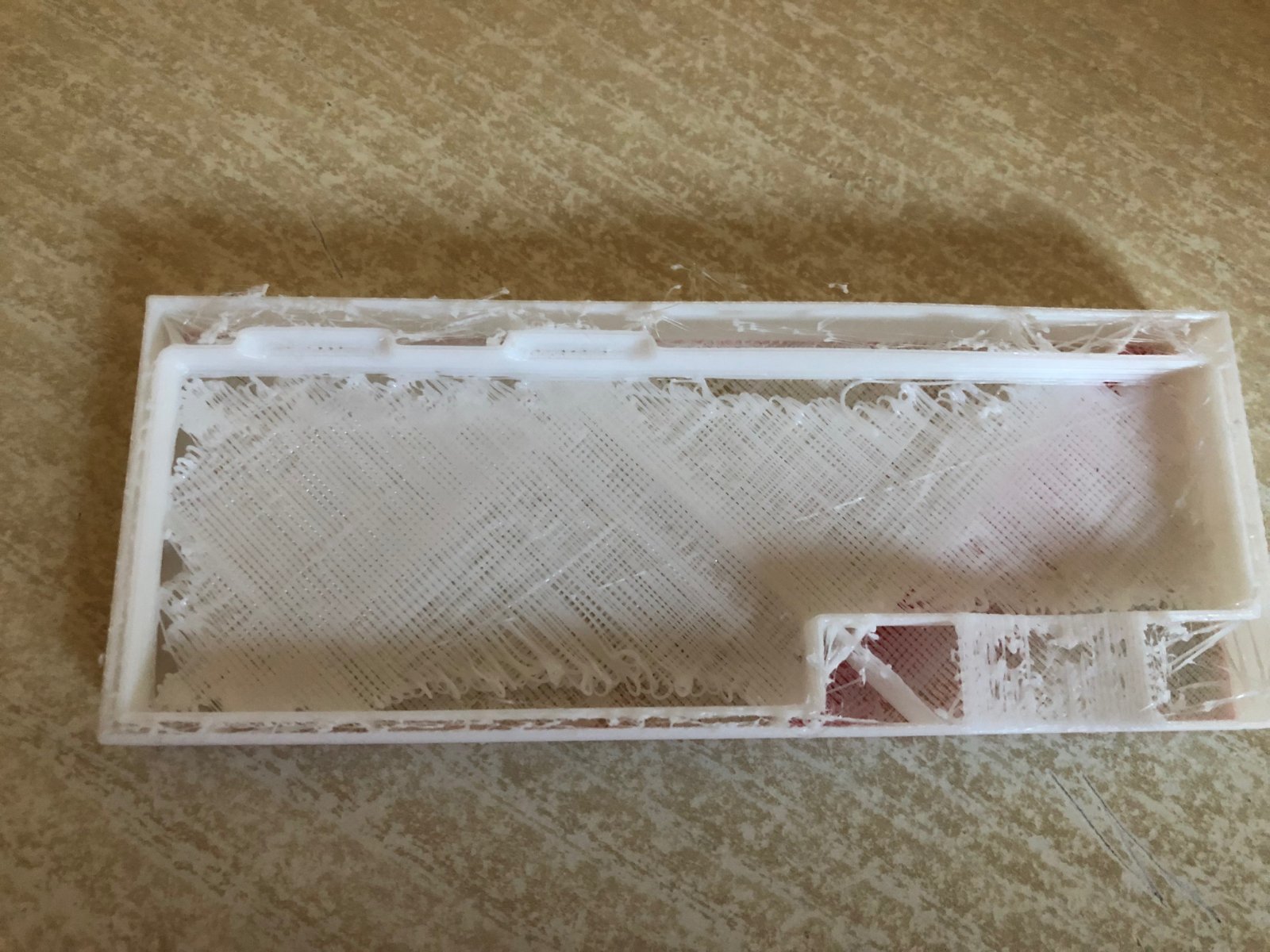

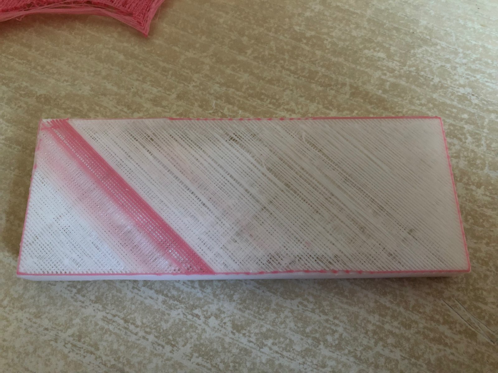

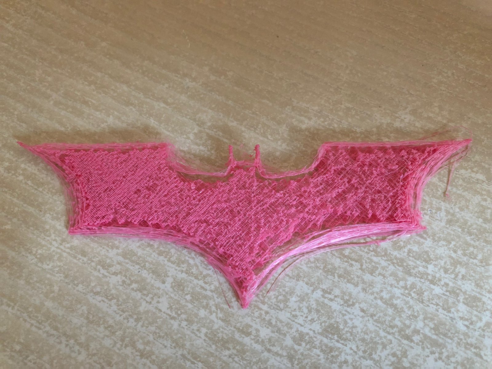

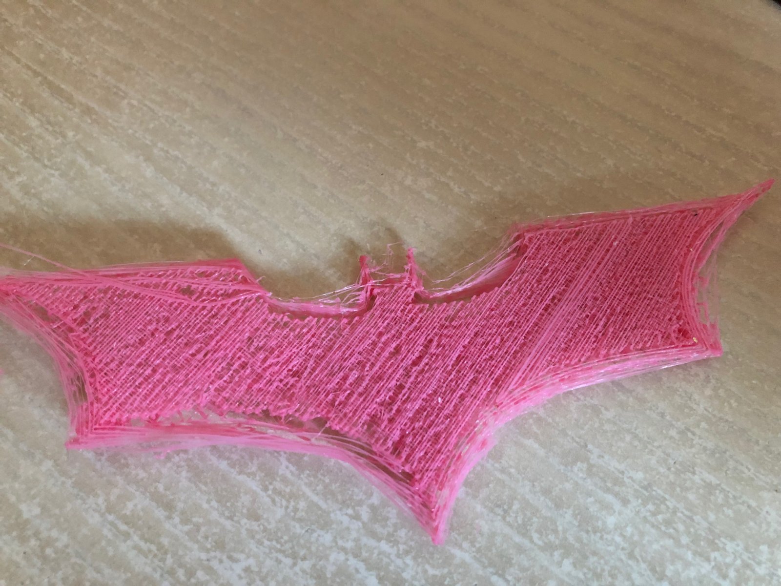

Hi all,
I buy a geeetech A20M 2 days ago. After many tries impossible to have a correct print (see pictures bellow).
there is empty space between the filaments of platiques (not enough and/or no flimament flowing from the extruders).
Strange that my 2 extruders have problems.
I also always adjust the bed (z=0) before starting a new print so that the paper rubs between the bed and the nozzle. But I can see that the paper does not pass between the nozzle and the bed each time that I start a new print.
Does this mean that the table is moving during the printing or is it normal ?
Can PLEASE someone help me ?
:cry: :cry: :cry: :cry: :cry: :cry: :cry:
==>PLA-Temperatures : 195°C/50°C
Best regards,
Shero1040

Re: extruder not pulling enough filament
Post by _kaktus_ »
Hello.
:mrgreen:
shero1040 wrote: Sun Aug 11, 2019 7:36 pm ...
This can be a natural phenomenon if the deformations are not great.
Under the influence of temperature, the aluminium hotplate can deform.
Geeetech filament, ABS only
