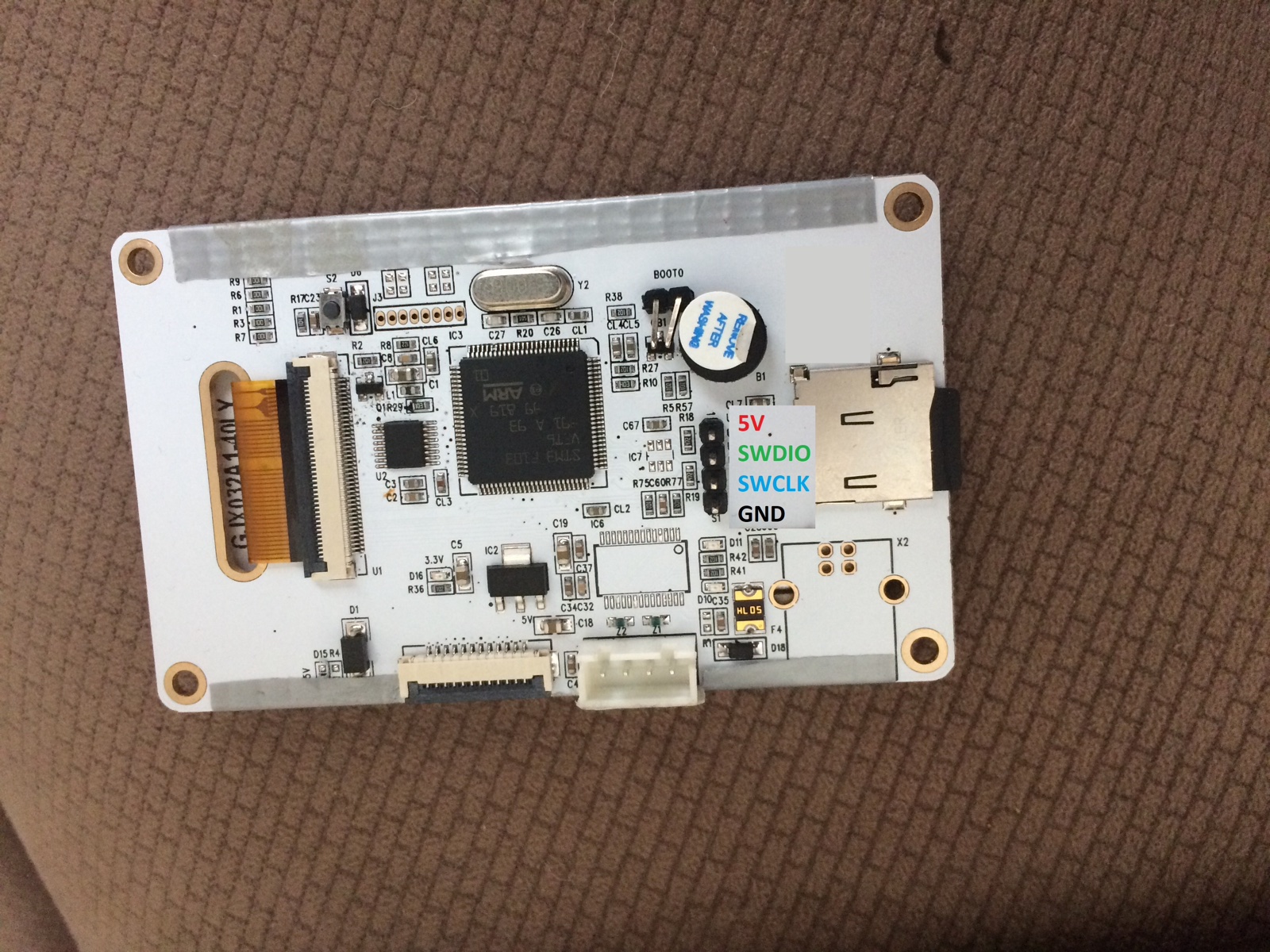

I found jtag pinout and connected the lcd via st- link. But I dont have flashing file to upload. Geeetech technical said me:Metal head: v2.02
Ceramic head: 1.32.41
The two versions are incompatible
Update the corresponding version. So I installed the wrong update.

Re: How to fix-E180>The screen displayed not correct or black screen
Lcd jtag connection pinout. For flash with st-link v2.
- B3632128-865D-4739-8D1C-F81E139C4714.jpeg (665.83 KiB) Viewed 49329 times

maybe you need this:
Motherboard application: E180_M04_V2_02.bin
Motherboard boot program: MotherBoot_bootloader_V1.0.bin
LCD screen application: E180_S01_V2_02.bin
LCD screen boot program: LCD_E180_bootloader_V2.0.hex
The SD card needs to be formatted before use, as shown in the attached picture. Note that when unplugging and inserting the SD card on the computer, the SD card needs to be ejected first and then removed.
The motherboard boot uses the "Flash Loader Demo" programming tool for programming, and the motherboard application uses the "firmware_tool_V2.0" programming tool for programming and must be the firmware_tool tool of version V2.0 or later.
The screen guide uses the ST-LINK emulator for burning, and the firmware is LCD_E180_bootloader_V2.0.hex; the application uses the "firmware_tool_V2.0" burning tool for burning, and the file is E180_S01_V2_02.bin, or the ST-LINK When recording, fill in the address as 0x08010000.
When the firmware is burned, the boot file is burned first, and then the application file is burned.
Everything was so beautiful. I did the narratives step by step and my lcd screen and motherboard were seamlessly updated to v2.02. Thank you very much to my friend William for their help.

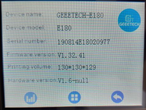

Sorry Mustye180, I wasn't on forum two months.
William - can You explain what is different V1 and V2 - I flashed my printer V2(metal hotend) flash from V1(ceramic hotend), and It working perfect.
On the information screen shows V1.6-null.
Now on download section the V2 firmware is enable, a little to late.
Regards
Regards
