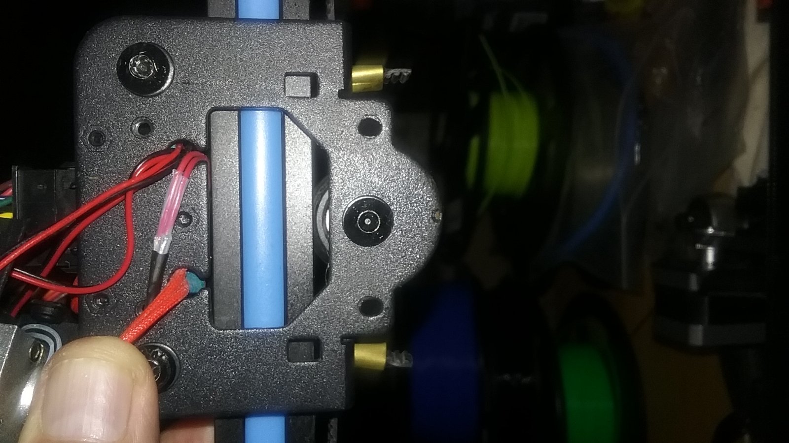

Well, I've got the mount printed and can see how I can mount the new hot end to it with appropriate lenght 3mm screws from the back of the plate into the back of the hot end, but I don't see how the plate mounts to the carriage. None of the hols actually line up.
I thought that the cage screw hole could be used by sandwiching the mount between the plate and carriage, but that doesn't line up. I must be missing something, but it doesn't appear to even come close to mounting on my A10M.
Does this carriage mount the same as yours?

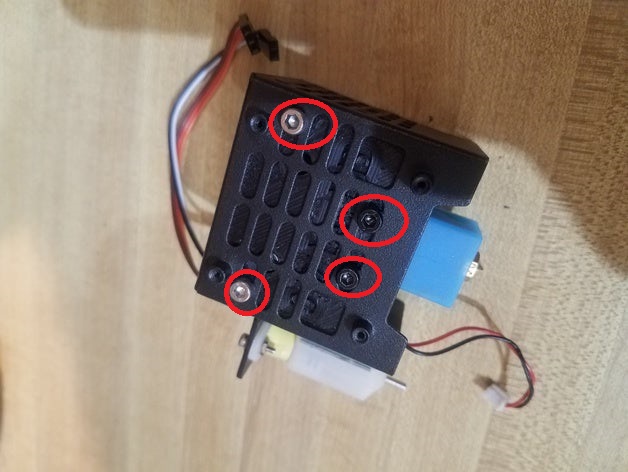

I have attached the picture showing the 4 screws that mount the adapter bracket to the oem hot end cover.

Thanks for the picture......I never thought that the mount was supposed to be attached to the cage, but it makes sense.
