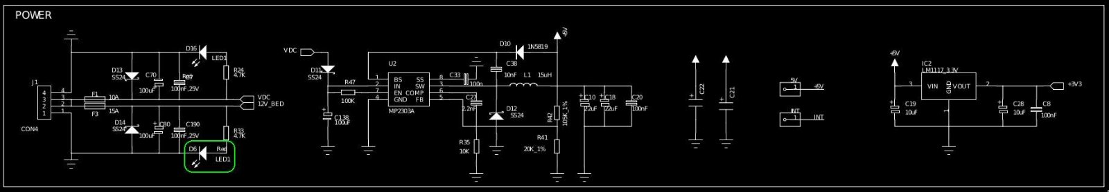

The PCB is a GT2560 (V 3.0) and the LED that turns on is the D6, 12VB

Browse through the circuit diagram below and tell us which fuse you burned.
I marked the same diode as you.
