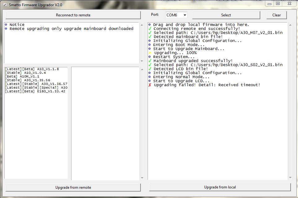

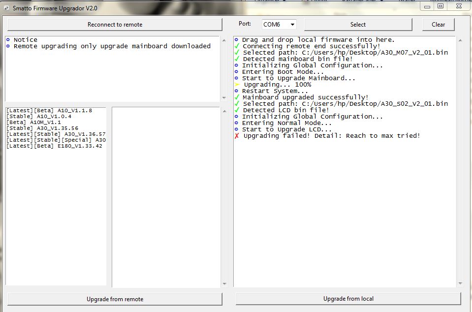

i tried to update the firmware, like you told me
the mainboard update is ok. when i update the mainboard, the 2 leds on the back of lcd turn off
the lcd update failed. the 2leds on the back ilcd stays on.
- update failed
- Capture.JPG (87.69 KiB) Viewed 6451 times
- update failed
- Capture 1.JPG (88.14 KiB) Viewed 6451 times

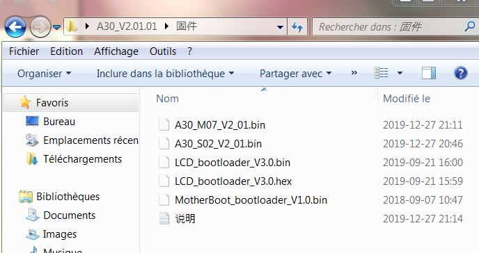

Hi
in the A30 V2.1.1 firmware update there is 2 files,
the first is UI and there is no mainboard and lcd firmware file.
the second is in chineese, and the bin files of mainboard and lcd is in the file.
- Capture 2.JPG (54 KiB) Viewed 6451 times

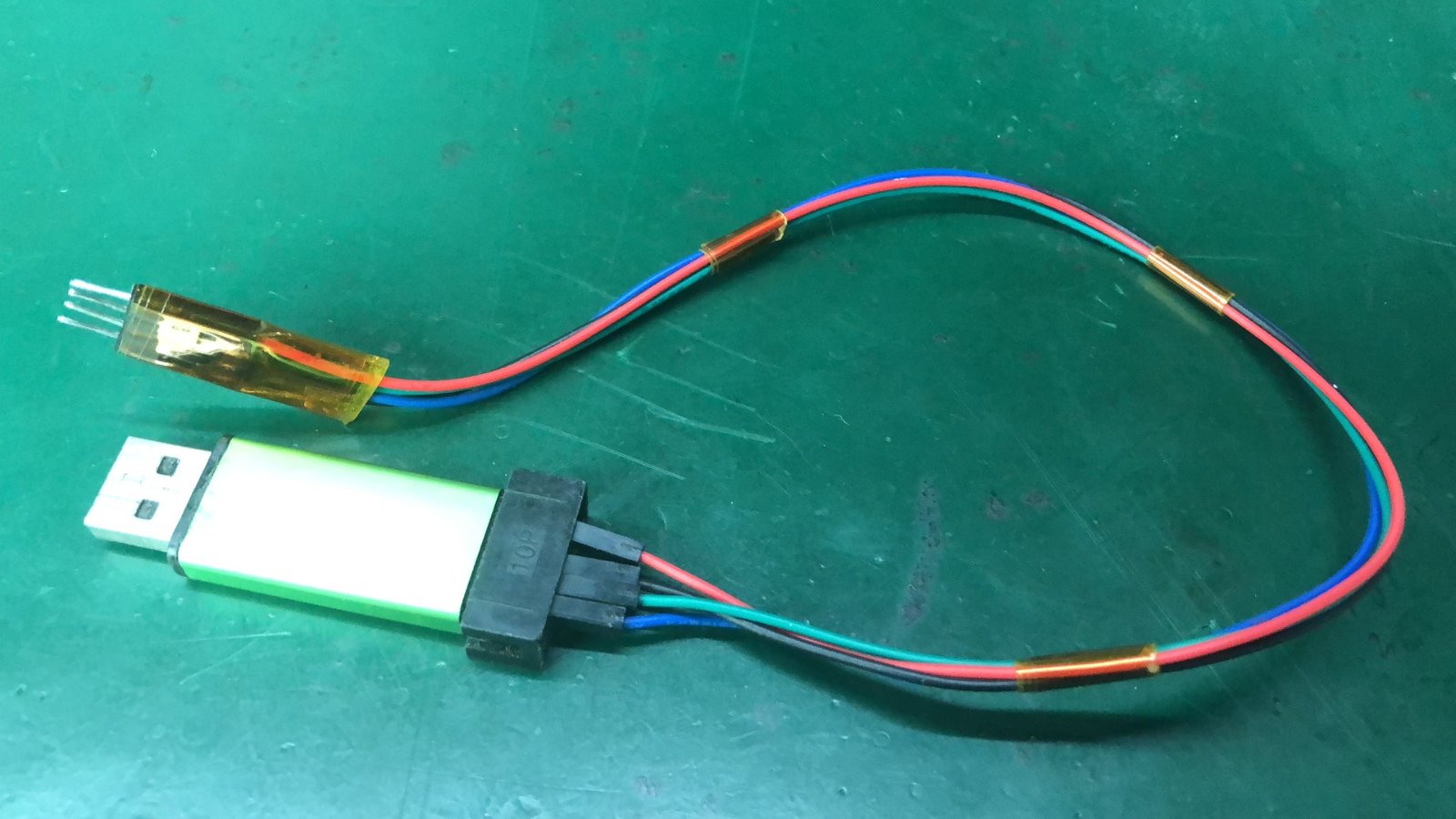

Hi,the screen firmware needs to be connected to the screen burning separately. Do you have a connection line as shown in the figure?
If not, we can send you a new screen and we will burn the firmware.
