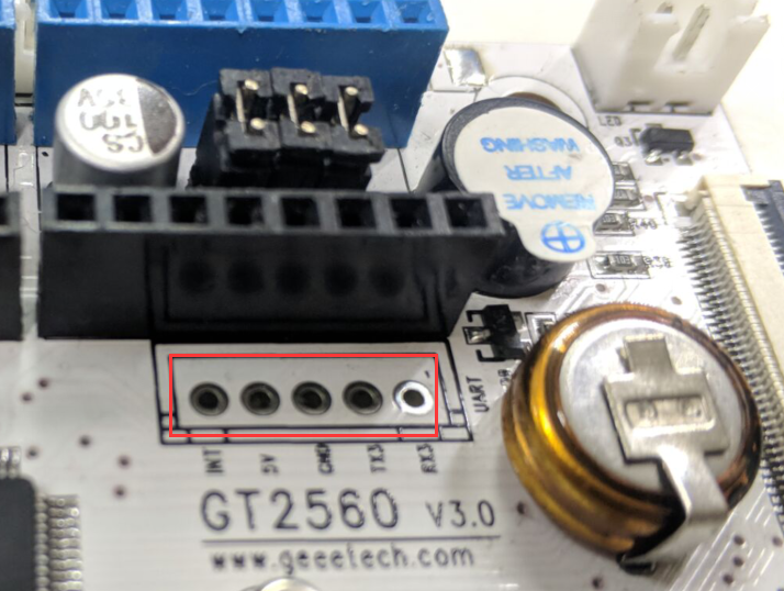

Thanks for your feedback.
I think :
1.Dual z motor+single 4988+single endstop
2.Dual z motor+dual A4988+single endstop
3.Dual z motor+dual A4988+dual endstop
The 3rd plan can give you the best experience.
By the same time,it need you do something for the motherboard:
1.You need to solder the motor pin for the Z axis no.2 motor on E2(e0,e1.e2).
2.Then you need to use the no define pin of the board for the new endstop.
3.Modify the fw and then upload it.
