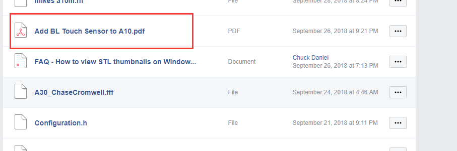

Re: 3D Touch Sensor:Auto-levelling for Geeetech 3D printer
For the MC2 work with 3dtouch/bltouch:
1.Print the stl for the sensor holder
2.Wiring the pin of Z max(3pin)+Z min(2 pin) for 3dtouch/bltouch
It needs the extension wires for it.(The default wires too short)
3.Edit the firmware
https://www.facebook.com/groups/315127105604393/files/
