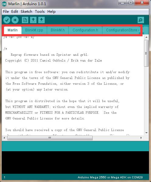

I noticed you just open one file to Arduino.
You need select all the files in the firmware folder and drag them to Arduino then upload...

pekkap100 wrote:Hi
ok but in this example: http://www.geeetech.com/forum/viewtopic ... 20&t=17181only one ino file open? Pekka
But have you noticed this?
It contains all the files of the firmware,while you have only one in your Arduino.
Did you get my idea?
