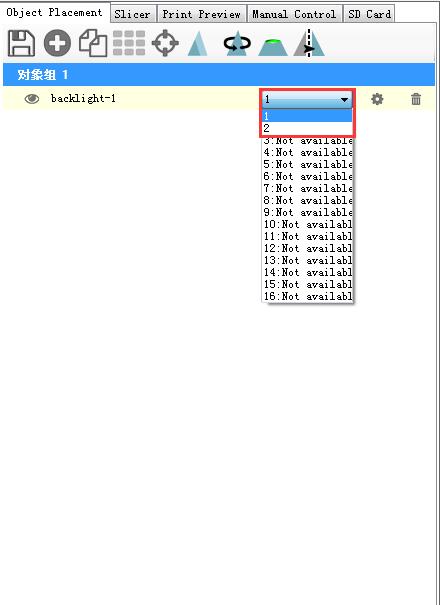

Does it make sense that if I'm only using one extruder it has to be extruder 1?
I tried printing something specifying extruder 2 in the gcode through simplify3D but the printer heated up extruder 1 and was using that. It left extruder 2 hot but was only printing on #1.
I have not yet tried using both #1 and #2 at the same time, that'll be this weekend.
Re: Problem with a Prusa i3 Pro C controller and Z axis
aja175 wrote:Does it make sense that if I'm only using one extruder it has to be extruder 1?
As far as i know,you can also use extruder 2 alone by specifying it before slicing.You can try Reptier Host again about that:
