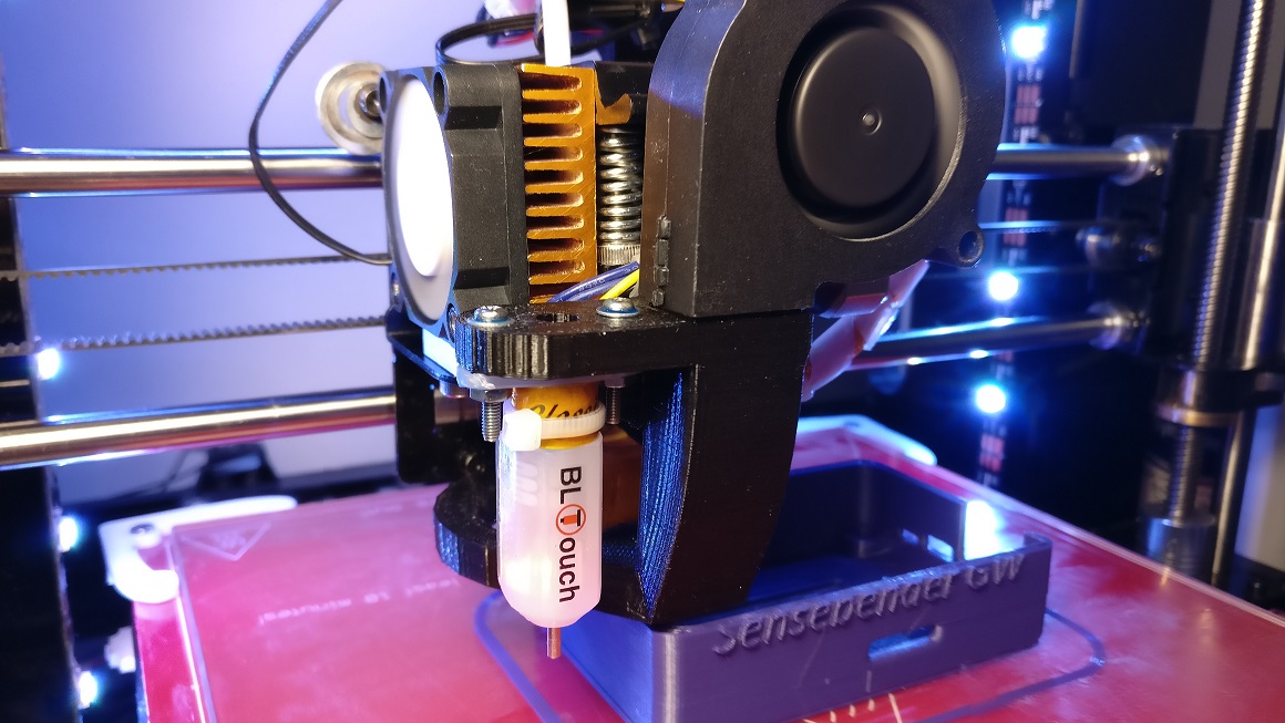

Btw, here I have my current config files that I use for the moment.
https://github.com/NiklasOlofsson/Marlin_GT2560
Please read the readme before using them.
Configuration.h should work with latest RCBugFix but you'll need to change the offsets for your 3D/BLTouch if you use the standard mount.
Set offsets to this:
Code: Select all
#define X_PROBE_OFFSET_FROM_EXTRUDER 4 // X offset: -left +right [of the nozzle]
#define Y_PROBE_OFFSET_FROM_EXTRUDER -44 // Y offset: -front +behind [the nozzle]
#define Z_PROBE_OFFSET_FROM_EXTRUDER -1.4 // Z offset: -below +above [the nozzle]
I use this fan duct so my offsets are based on that.
http://www.thingiverse.com/thing:2039119
- IMG_20170401_182229.jpg (384.08 KiB) Viewed 16122 times

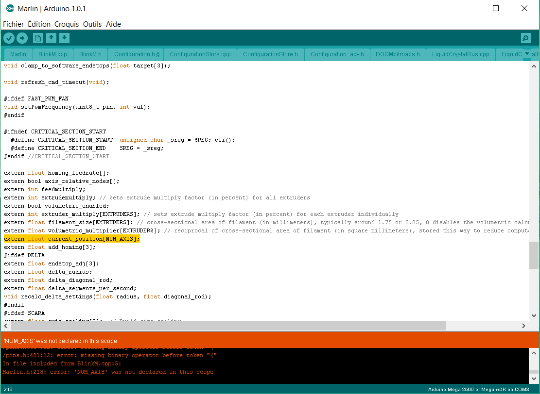

I copy and past your files in firmware I found here
viewtopic.php?f=27&t=18263
I modify the offset and try to compile the firmware but I have this error
- error.PNG (47.17 KiB) Viewed 16117 times
Re: Latest Marlin RCBugFix branch for PI3 Pro B
Posted: Sun Apr 02, 2017 12:52 am
by Rv8
ok thanks I think I begin to understand, I know I'm slow lol ...
To be sure could you confirm me please ?
1-I download this file
https://github.com/MarlinFirmware/Marlin/tree/RCBugFix
2 I download your file
3 I copy your files and replace original file from RCBugFix BUT very important ! without replacing original Configuration_adv.h
4 I replace the code in Configuration.h: with the informations you gave me ?
Am I right ? Thans a lot
