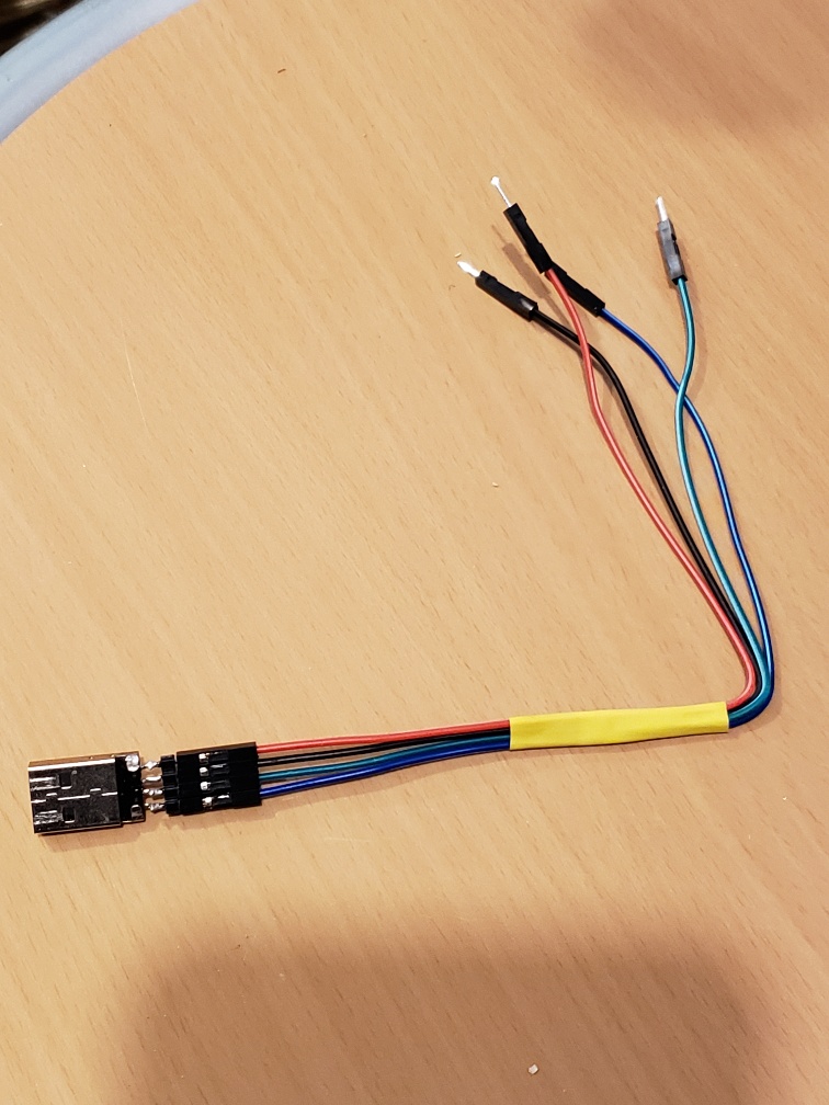

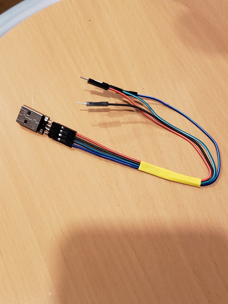

I made the cable
I made the cable
- cable
- 20200509_152412_resized.jpg (210.49 KiB) Viewed 7889 times
- cable
- 20200509_152146_resized.jpg (205.9 KiB) Viewed 7889 times

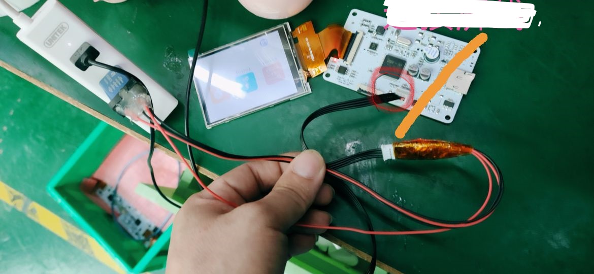

You can follow these steps:
1. Burn the motherboard boot program: The motherboard boot program uses the "Flash Loader Demo" burning tool to burn.
2. Burn the motherboard firmware: The motherboard firmware is burned using the "firmware_tool_V2.0" burning tool.
3. Screen boot program: The screen boot program uses the ST-LINK emulator for burning, and it needs to connect the computer and the screen with a cable (note that the screen line should be inserted into the interface below the screen, as shown in the figure.After the programming is completed, connect the interface to the one above.).
4. Burn screen firmware: The application uses the “firmware_tool_V2.0” burn tool to burn (the same as the method of burning the Screen boot program), or fill in the address 0x08010000 when burning with ST-LINK.
Since the motherboard boot program and firmware were already burned when it left the factory, you only need to re-burn the screen boot program and screen firmware.
If it is still unavailable, you can burn all of them again.

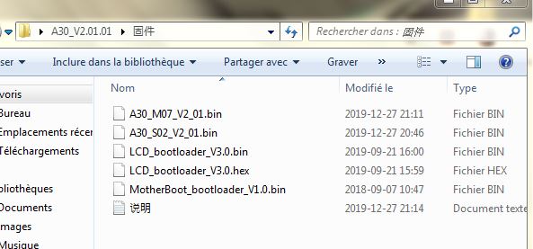

Hi ,
1- I have MotherBoot_bootloader_V1.0.bin , not V3.0
2- What is the ''Flash Loader Demo '' ? to burm the motherboard boot programm .
3- I don't have a ST-LINK emulator, i cut a regular usb connection and soldered 4 cables.(see the picture).
- MotherBoot_bootloader_V1.0.bin , not V3.0
- bootloader.JPG (40.38 KiB) Viewed 7871 times

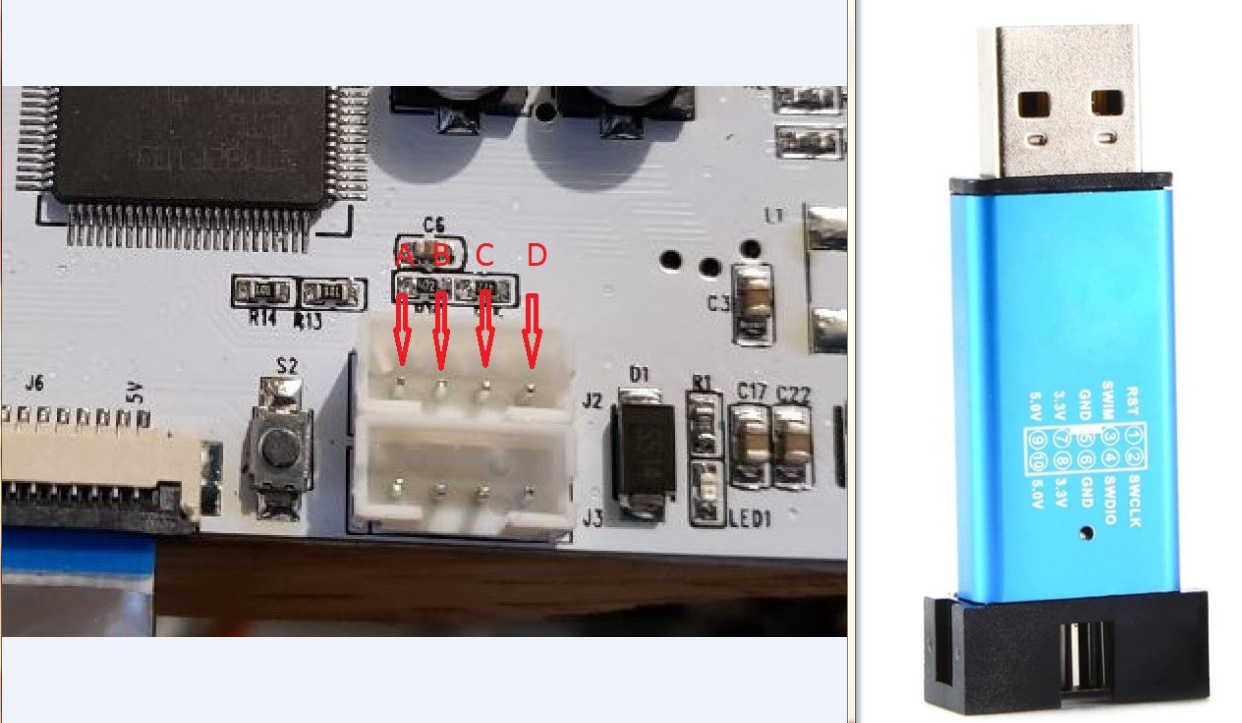

Hi William
I know you will send me a new screen. Thank you.
I ordered a ST-LINK, and I want to try to burn the LCD firmware untill i get the new screen.
I need diagram connection between the lcd and the ST-LINK.
screen pin A to witch st-link pin ?
screen pin B to witch st-link pin ?
screen pin C to witch st-link pin ?
screen pin D to witch st-link pin ?
p.s. Look at the pictures
I really appreciate your help.
Best Regards
Alexy

- diagram connection
- Capture.PNG (785.09 KiB) Viewed 7857 times
