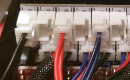

oroszjrobert wrote:Acrylic Geeetech I3 pro B 3D Printer kit
I need some help.
Assembled it correctly but the z axis does not stop after it pushes down the z axis minimum button ( I hope that is how you call that)
I have the same issue in the case of auto-home also same when I set the home setting manually. The motor keep stopping at the end point and is forcing itself but it will not go any further.
I hope you understand my issue.
Thanks in advance
Did you have all the endstops correctly conneceted?See the following picture:
