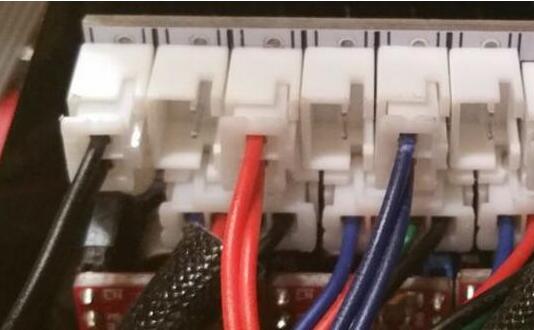

Acrylic Geeetech I3 pro B 3D Printer kit
I need some help.
Assembled it correctly but the z axis does not stop after it pushes down the z axis minimum button ( I hope that is how you call that)
I have the same issue in the case of auto-home also same when I set the home setting manually. The motor keep stopping at the end point and is forcing itself but it will not go any further.
I hope you understand my issue.
Thanks in advance
Re: How to install the firmware for GT2560
Posted: Wed Feb 08, 2017 5:54 pm
by bang
oroszjrobert wrote:Acrylic Geeetech I3 pro B 3D Printer kit
I need some help.
Thanks in advance
Did you have all the endstops correctly conneceted?See the following picture:
Posted: Thu Feb 09, 2017 6:05 am
by BrendanJ
I need some help.
Thanks in advance
Are you driving the Z-axis steppers independently using separate drivers (Z2 option)? If you are you may need to add a line of code to define the home retract distance for Z2 in the Configuration_adv.h file of the firmware.
