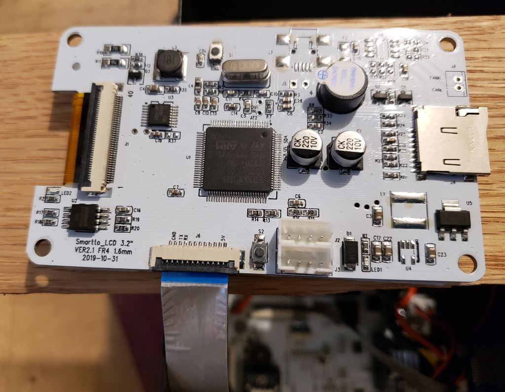

where i connect LCD A B C D pins on ST-LINK pins ?
- connection ????
- connection.PNG (1.23 MiB) Viewed 7683 times
Re: LCD display problem
I've this one and need to connect the VCC, GND, SWDIO and SWCLK of the SKlink to the LCD board but I do not know what is the pin setting of this LCD board and I do not find it anywhere. SD updating does not work. I've read that I should copy only the content of the UI folder to the SD card. Or do I've to copy all of the firmware file ?

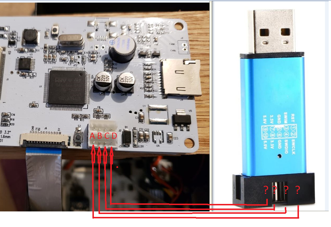

Hi William
Look at my picture and tell me where i plug the lcd screen pins A B C and D to ST-LINK pins ? thanks

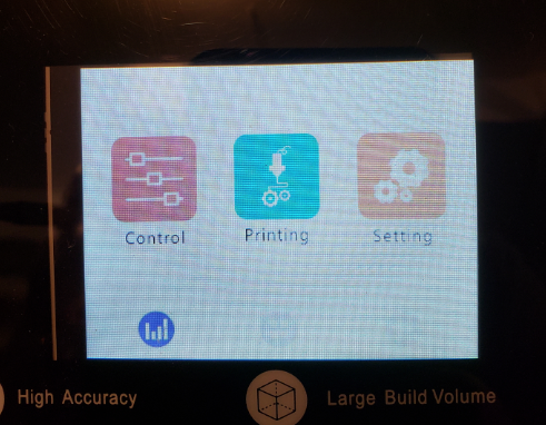

Hi
I received the screen today and I installed it as you told me, it turned on, but when I clicked on the icons nothing happened.
The sd card in the control box slot is empty.
I ask you what to do first to avoid creating a problem.
Should i copy some files to the sd card, if yes, which files ?
Thank you.
Thank you.
Hi,is the motherboard firmware burned?
You need to restore the factory settings.
If the screen does not respond, it may be that the screen cable is not plugged in properly, you can unplug it again.
Yes, the motherboard firmware is burned A30 M07 V2 01 bin.
the screen cable is plugged properly. The sd card is new and empty.
How can i restore the factory settings ?

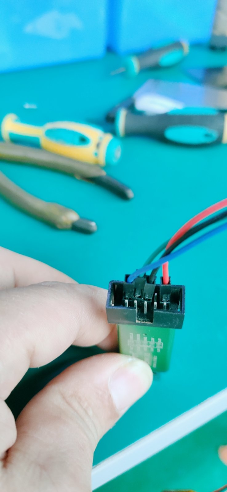

Hi, did you burned the firmware screen before sended to me ?
Yes, the screen we sent you is burned firmware. If it cannot be clicked, there may be a problem with the screen. Can you show me the screen wiring? you can do this:

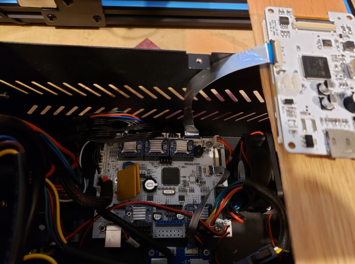

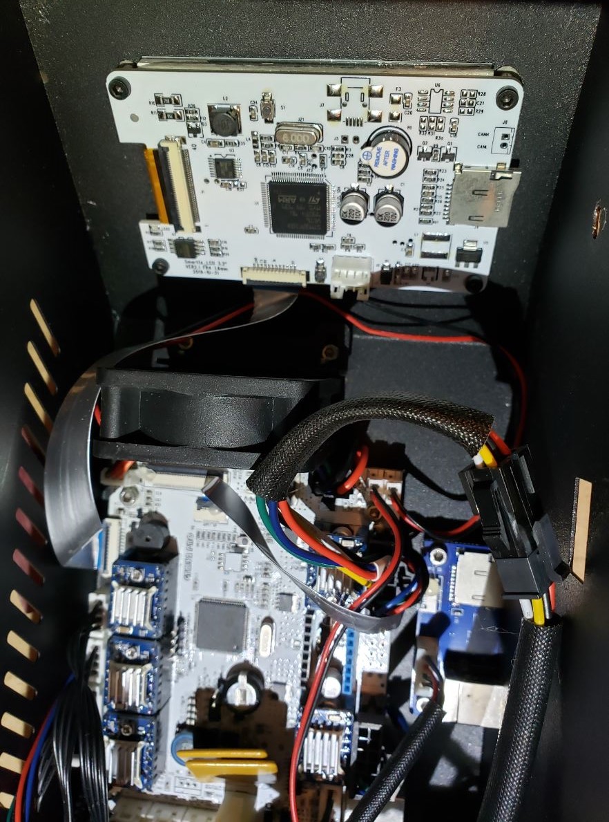

Hi
Here are the photos of the screen wiring.
P.S. where can i found the MotherBoot_bootloader_V3.0.bin (CRC32: A81D6687) ?
Thank you
Thank you
