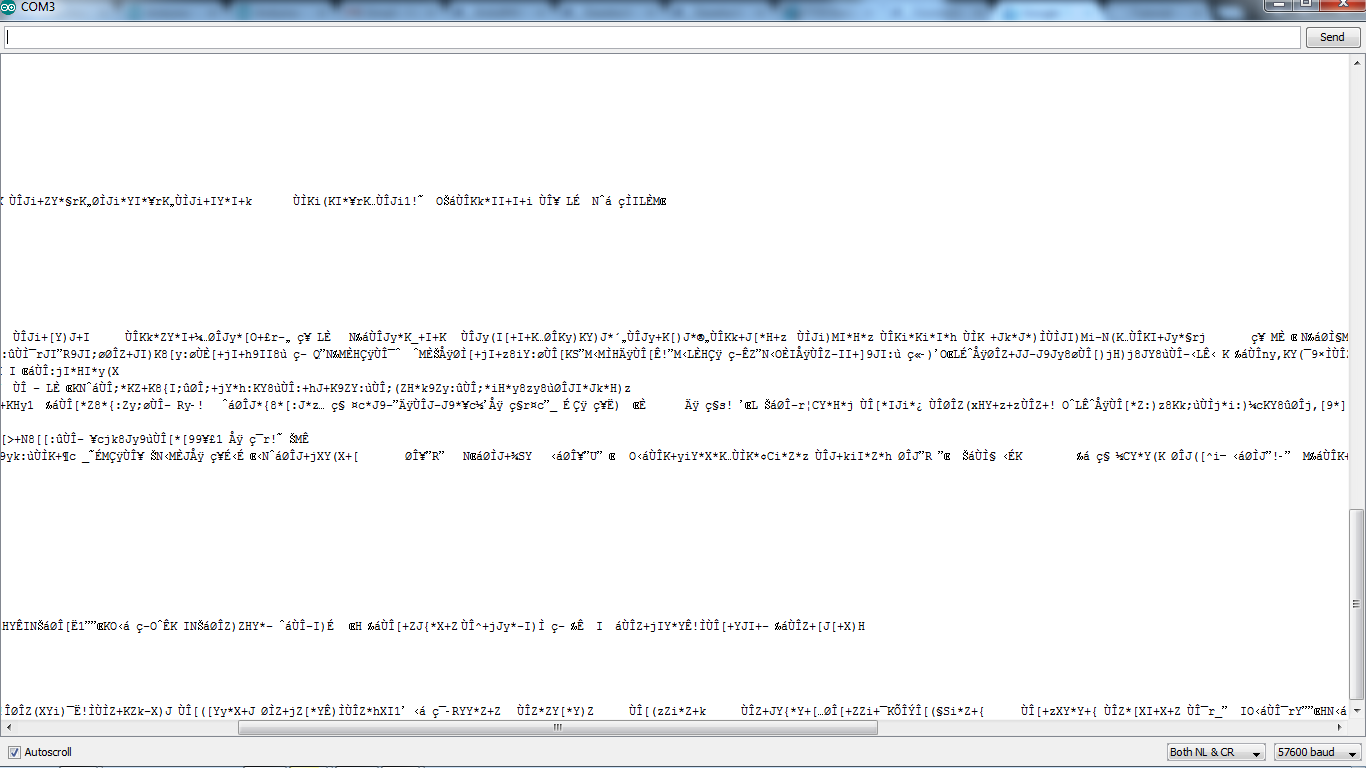

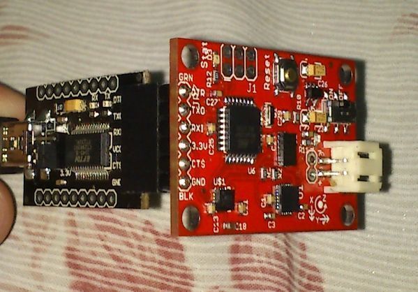

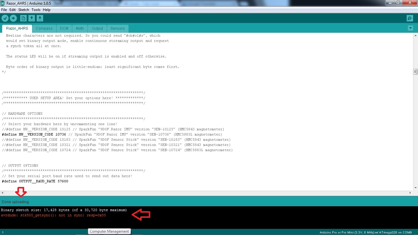

when I upload the program AHRS to the IMU 9dof result as in the picture "trouble" in the attachment and the serial monitor nothing happened. Then I tried with the configuration just as in the picture "FTDI-imu 9dof" in the attachment, and when I upload the program again to 9dof IMU is succeed (done uploading) but when the serial monitor results as in the picture "result" in the attachment.
Which the correct configuration? and how is the correct step? I've been following as the https://dev.qu.tu-berlin.de/projects/sf ... i/Tutorial but still could not well. This confused me, and I also still new to using this 9dof IMU module, please help me ... This module is very important for my final project ... :(
