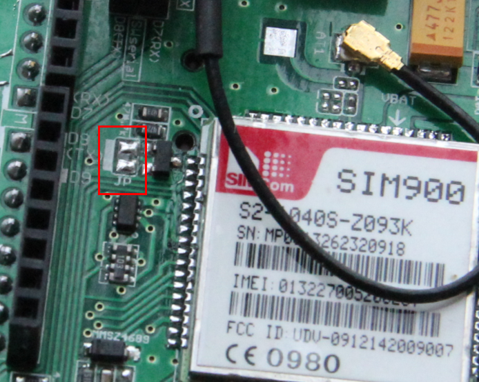

you shuld weld it like this

Old post, but I found it worth of nothing and I want to open questions why JP need to weld? That JP is used only for get D9 to working to start and shutdown GPRS Shield by arduino
Software Triger; If use this way to power up the GPRS Shield, JP need to be soldered, then Digital Pin 9 of the Arduino will act as Software Triger port and Digital Pin 9 can not be use as other purpose.
I have just same problem as Zital have. What wrong is with software mode in arduino or GPRS Shield v1.0?
