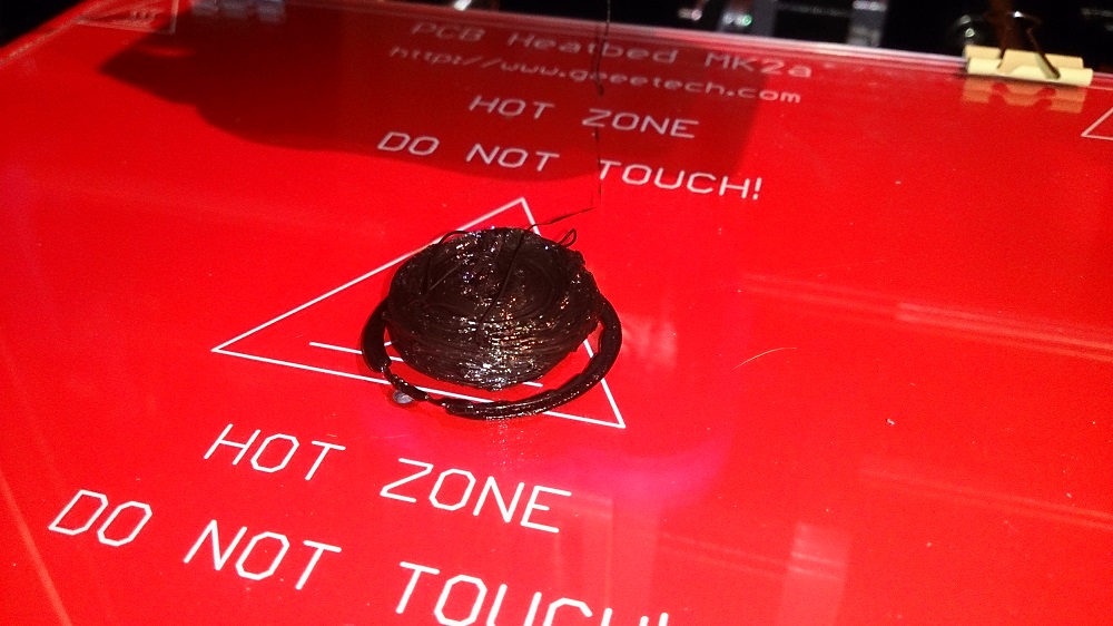

When I print a object it does not look good. The nozzle touches the filament during printing

I'm probably doing something wrong, my prints look awful. I made a movie of printing with my Prusa i3a.

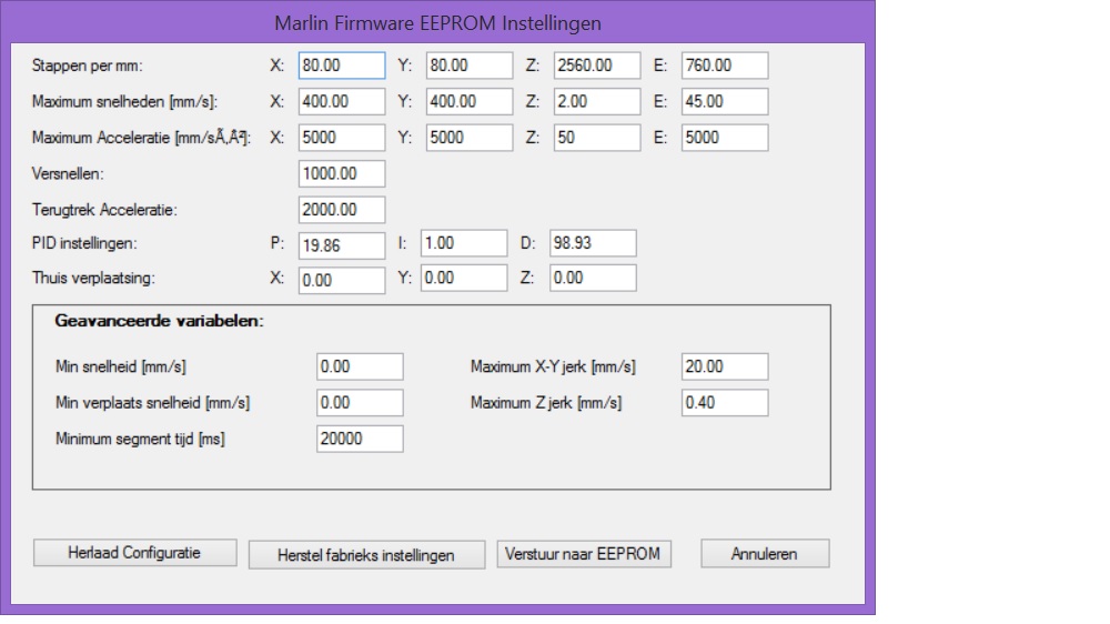

- reptier eeprom read
- settings.jpg (100.37 KiB) Viewed 16119 times
- my print by the prusa i3a
- print01.jpg (190.36 KiB) Viewed 16119 times

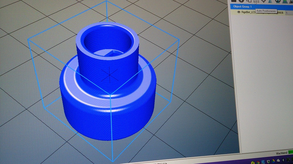

- stl of a print
- print02.jpg (241.5 KiB) Viewed 16119 times

I have performed a new installation of repetier / slicer and Cura. Still the same problem with both. The distance is less than 1mm, adjusted with paper.
Have also tested with glue, Kapton tape and painters tape.
It continues to stir in the filament and the layers are still not equally

I have a similar problem.
I think it is the step calculation in firmware.
Geeetech should provide these settings for each kit.
Define DEFAULT_AXIS_STEPS_PER_UNIT
or at least enough info so we can calculate it from this calculator: http://prusaprinters.org/calculator/#stepspermmlead
