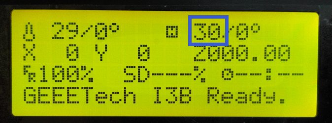

When you are heating the extruder, is the temperature of hotbed raising? If so ,please connect the wire correctly, because you connect the exturder thermistor to hotbed pin.

Thank you for your reply turns out i had the hotend plugged into the wrong spot I had it plugged in where the #2 hot end would go. Movd wires and works fine
