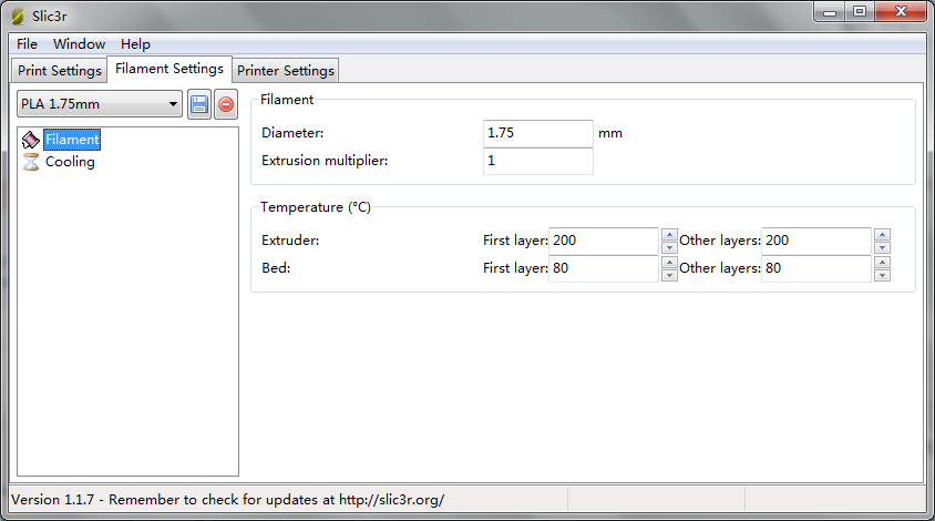

zhangxueyou
Posts: 1405
Re: Printing Quality
Post by zhangxueyou »
Actually , the main difference between ABS and PLA is temperature. Look at the picture:

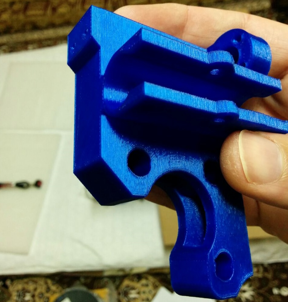

leonardo.galardi@gmail.com wrote:Using the setting you sent I had an enormous improvement. See the results :).
Do you have similar settings for 0.1 mm PLA?
Thank you
Leo
