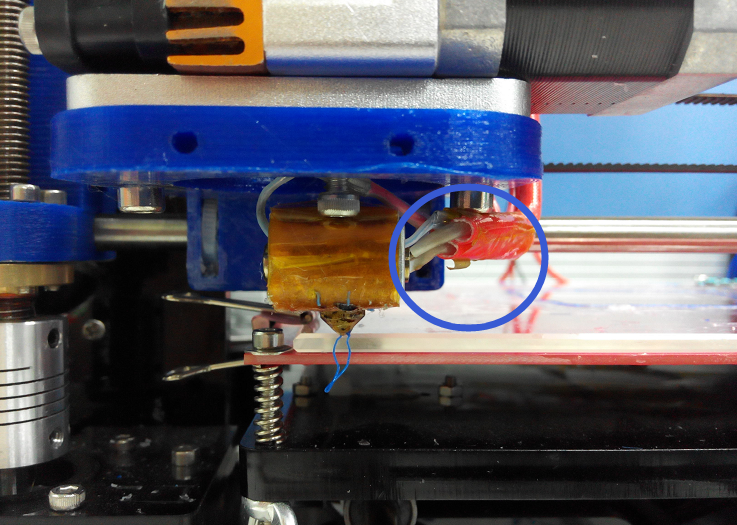

I'm quite happy of my I3 that prints quite nicely but a bit worried of the auto home position that seems to close to the screw (see the picture).
What is wrong ? The auto home position is related to the x and y-axes switches, how can I move the auto home position ?

Hi, please look at the picture, can you see any difference from yours?

I have added G1 Z10 to my custom GCode in slic3r to avoid that bolt when moving.
I added:
G1 Z10 ; clear bolt
G1 X10 Y10 ; move away from bolt
After that it puts the printhead to the glass and starts printing

I have the same issue so I looked at the Custom G-code in Slic3r. On my Start G-code I have the following:
G28; home all axis
G1 Z5 F5000; lift nozzle
should I add the code below after the last line above so it looks like this?
G28; home all axis
G1 Z10 ; clear bolt
Thanks!

it's ok,but everytime you print,you should rise the extruder a bit ,and then move it to the coordinate:( x10,y10).
