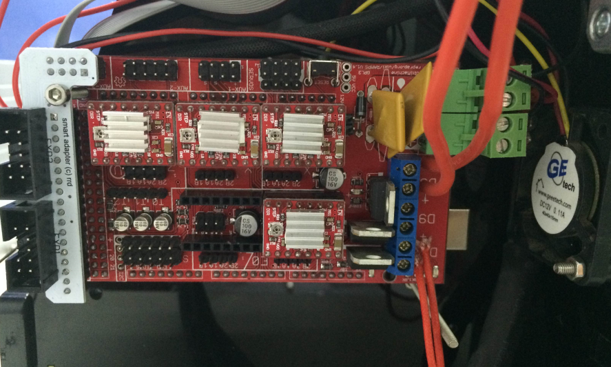

As I say in the email, cooling the MOSFET is very important. If you mount the mainboard in other directions, the cooling fan will be vain. As you heat up the hot bed, the temperature of MOSFET will raise quickly, it need to be cooled down, or it will be burnt out like yours. You have to replace a new MOSFET now.

Sorry to bump into this thread, I have not yet totally completed the building of my i3 pro B, but I'm concerned about this problem as well. I'm using iduino mega R3+ramps1.4 and there are only two directions I can put the board. Either I put the board USB port facing the fan, which is impossible without removing the fan (and leaves very little place to actually connect anything in there), either I put the board USB port in the opposite direction, in which scenario the LCD/SD connectors will totally mess with the fan airflow (see picture below). Since I'm gonna used the USB port, I'm choosing this last solution, and I have planned to use a 92mm fan connected to a computer to cool the board (until I can print something like a board case to handle a cooling fan on top).

This is how I mount the mainboard, use a screw and power cable to firm it.

Well done, at least your board fan do not seems as useless as mine ;)
Are you able to fit your USB cable in there ? Mine can't fit if i put the board the same way you're showing here.
