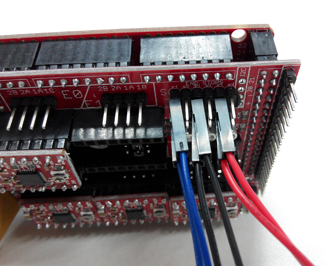

How do you connect the endstops? they should be connected like this:

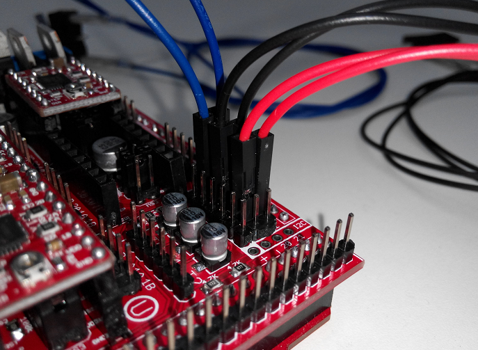

i have attached my pictures of my end stoppers. the one end stopper with the zip tie, i didn't have enough nuts for those screw size
Re: Ramps 1.4 + Mega2560
Posted: Sat Apr 25, 2015 10:21 am
by Jsantos1214
my end stoppers

You connect the x and y endstops wrong, you should swap their connections. form left to right should be x, y,z.
And I suggest you should change the direction of mainboard to let the fan cool the MOSFET down, or the MOSFET may be burnt out when heating.

ok i have moved the cables to the correct way on how you have it. i turned the power off and back on and im not getting any thing to display on the screen.
i know that you have the board in the other direction, but i'm not able to get the usb cable in with the fan being in the way. i was hoping to print a box to make a cooling tunnel.

so since i changed my cables around, my x, y, z are all off. my colors are not the way how u had it. i followed the board instructions and i have to go back to how i had it.
