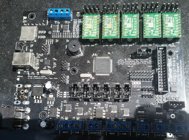

Hi, I have the original power supply for the Makerbot. It has a four pin connector. My Mightyboard has only two slots. On the underside there is what looks like a transistor or a diode.
If I replace the two pin female connector with a four pin female connector, will it break because of the diode? Or is it ok so I don't have to cut my beautiful male 4 pin connector.

I just plugged my new Jameco power supply into the Mightyboard and immediately got smoking capacitors. I think I plugged everything in correctly, as the two +24V wires were going into the + side and the two - wires were going to the - side.

I just read the schematic for the Geeetech Mightyboard Rev E.
Are the correct inputs 12 V, not 24? I have TWO fried boards!!
I want a refund or I want to know what capacitors I can fix.

Which capacitor is smoking?
More than one was smoking. I tried plugging it in again after you said that to check, but I couldn't tell.

Can you post a pic here? And the way you connect it, I want to know which capacitor is smoking, tks!

Mark wrote:Can you post a pic here? And the way you connect it, I want to know which capacitor is smoking, tks!
Here's the picture. Can you help?
