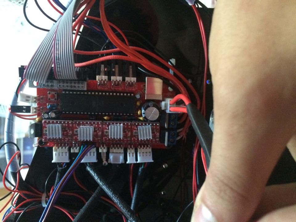

Could you please take a photo of mainboard with wiring, let me have a look.

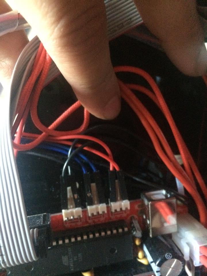

You plug y motor and one of the fans in wrong direction. I am worried that the fan is dead.

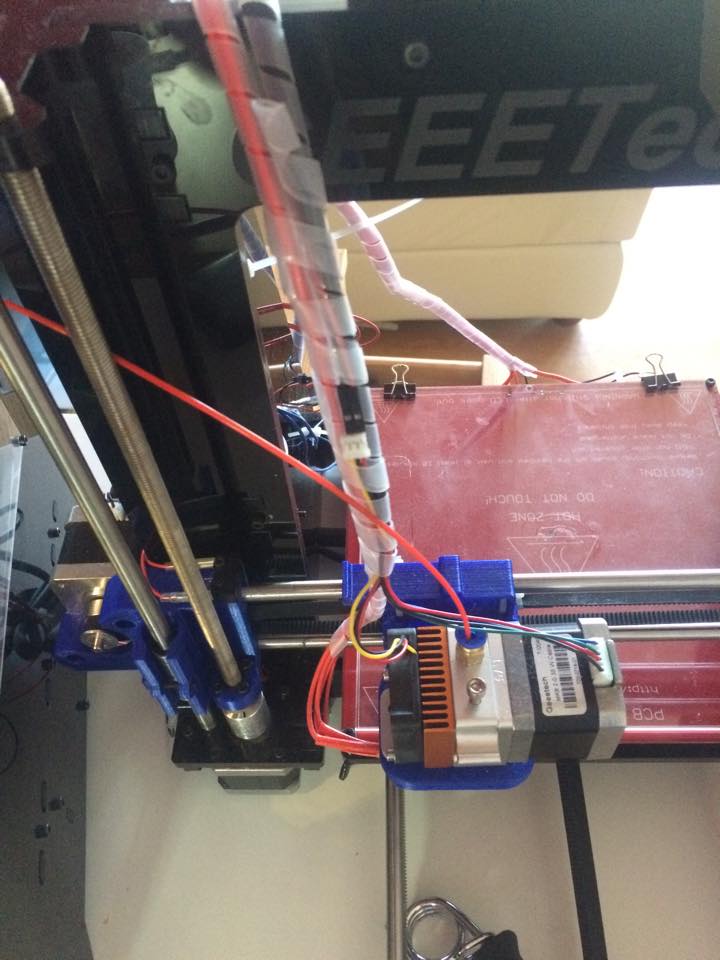

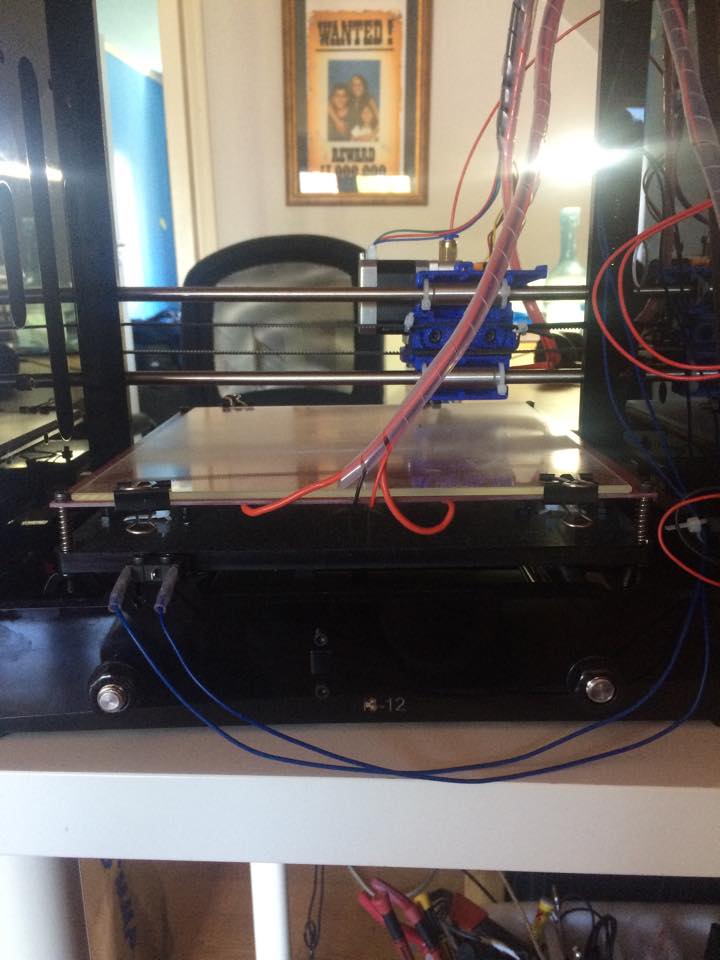

And please take some picture of printer(front side, back side, left side), I want to see the color of endstops wires.

oki Ill try to fix it but the y-motor will go in the wrong direction thats why I plugged it that way.

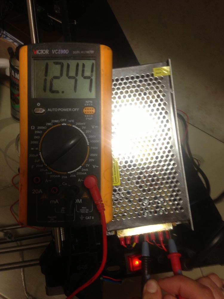

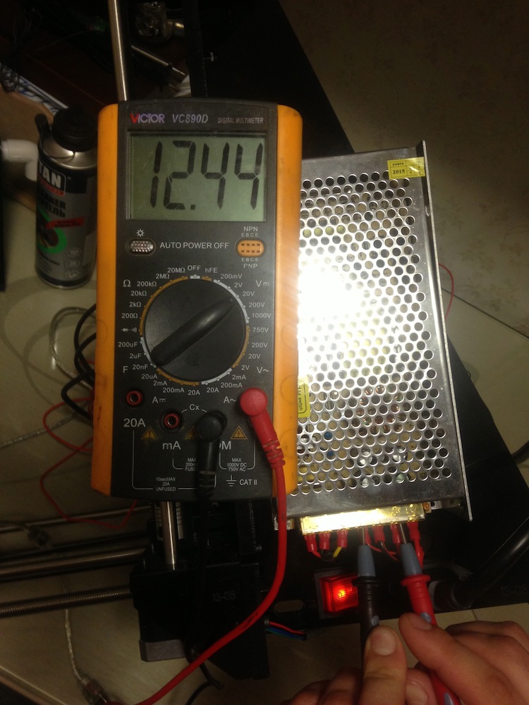

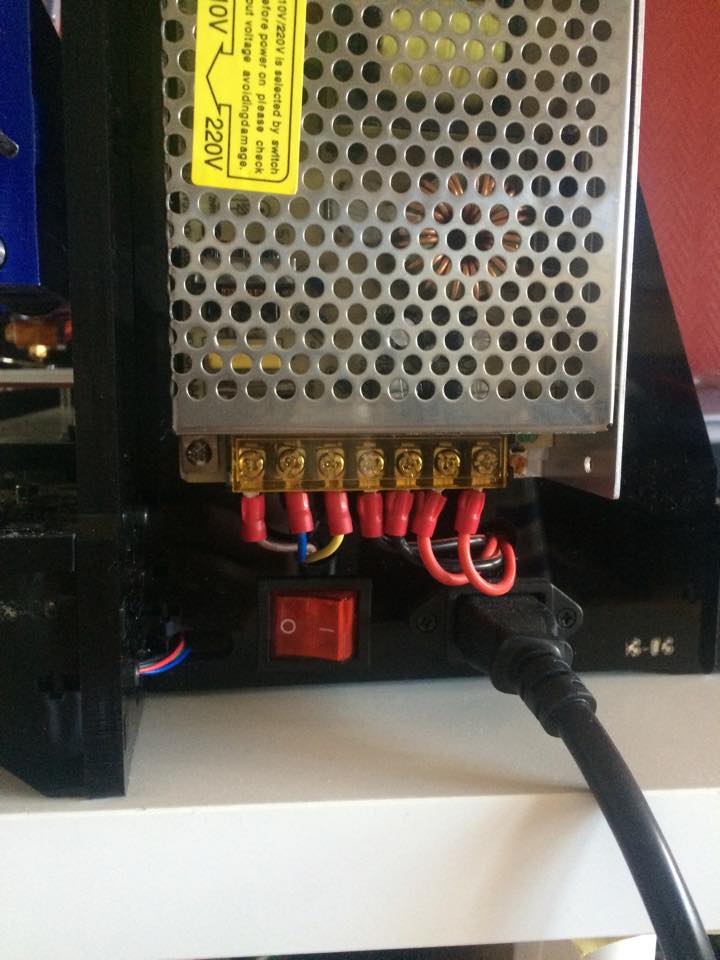

Do you have a multimeter? If you have, please test something:
1. Test if there are 2 groups of 12V output voltage from PSU when you turn on the printer. 2. Can you move the x axis by your hand easily? If not, please loosen the x belt slightly.

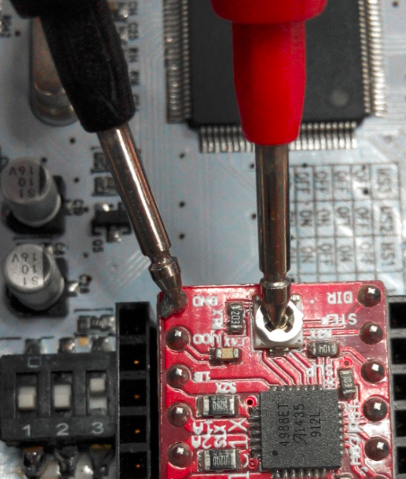

If you can move the x axis easily, test the voltage between the screw on x motor driver and GND as shown in the picture, the voltage should be around 0.9V, rotate the screw slightly to calibrate the voltage:
