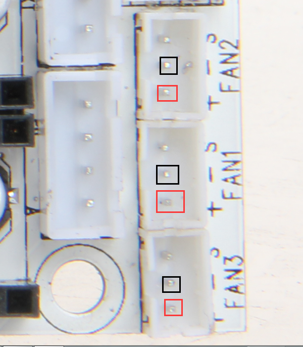

Is there a fan near the hot end?
Re: Upgrading to Bowden Extruder
Posted: Thu Jul 02, 2015 7:43 pm
by jfsgi
Well the fan is where it came pre-mounted, having said that it is not wired as you provided a fan with a 2 pin fan knowing I have a 3 pin controller. So I have now tried the other extruder I purchased to see if I had a bad one and get the same results.
Please advise or replace the two extruder assmeblys I purchased.
There is nothing better than buying something you can not use.
Posted: Fri Jul 03, 2015 5:50 pm
by zhangxueyou
If the fan has only 2 wires, the order of connection is as shown in the following picture:
connceting fan.png (428.06 KiB) Viewed 17621 times
