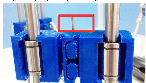

I hope someone has a nice easy to follow method to zero and level off my XYZ. I am trying to follow this http://www.instructables.com/id/Using-R ... ng-G-code/ but if I send a GCODE command like "GO X0 Y50 Z2" the printer tries to punch the nozzle thru the bed. I can get it to stop in the center of the bed using Z10.
It also mentions this "If the 3 numbers differ too much, you can manually move down the print head until the nozzle just hit the print bed, and screw the endstop screw tightly, if the screw has no room to adjust, you need to change the following setting later, record it. E.g. Change 213.5 into 214 ". Can somebody please tell me where this "endstop" screw actually is?

hi,here is the latest upgraded firmware for rostock mini g2.it will help you zero/level xyz better.please reburn the firmware.
the endstop screw is shown in the picture.good luck.
