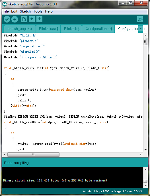

The firmware sent is exactly the same as downloaded in original instructions. This will not compile because of missing file!! I was hoping firmware you sent would have error corrected. Have you tried compiling this firmware?
Please do so and correct.
Mark
Posts: 1553
Re: Rostock G2 Mini - G29 breaking carriages
Post by Mark »
But I can compile it successfully. .
