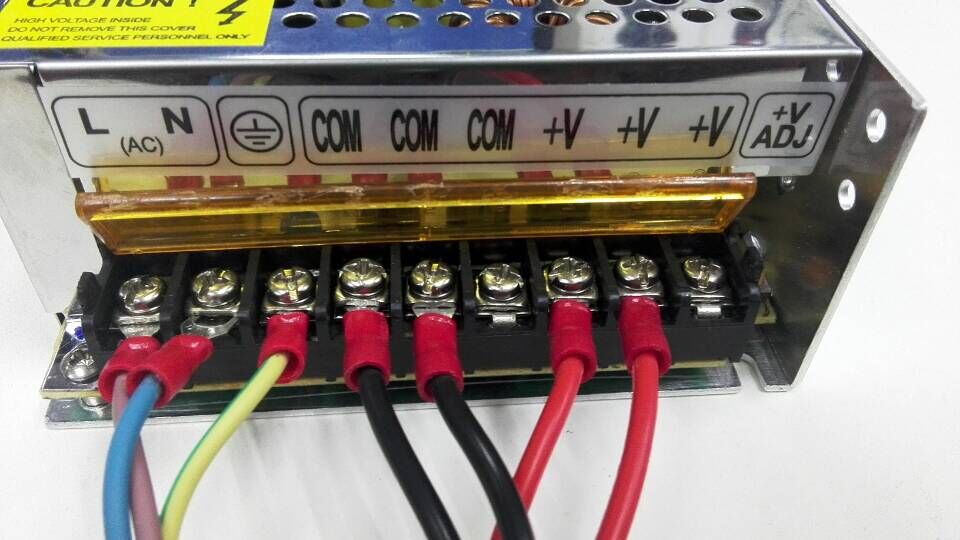

I am trying to wire up my power supply for my Geeetech i3 Pro B. I have 7 wires to connect, which matches what is shown in the instruction guide. However, the pictures in the guide show only 7 screw terminals. My power supply has 9 screw terminals. The guide does not state which terminals to connect to, so I want to be absolutely sure I am wiring these up correctly. Here is my assumption:
Red (2 wires): V+
Black / Red Stripe (2 wires): COM
Yellow / Green Stripe: Ground
Blue: N
Brown: L
Can someone please verify that this is correct?
Thanks!
Sherry

yeah,it's right.

Thanks!!!
