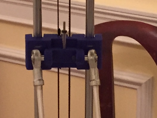

I am having the same problem. How do you "so please adjust the hot bed plane"? Do you adjust this by adding washers or something under the end-stop screw.
- End stop screw
- carriage.jpg (49.8 KiB) Viewed 15933 times

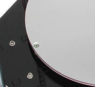

How about adjust the 3 screws to make the points around the bed in a same plane.
- QQ截图20150825154408.jpg (36.8 KiB) Viewed 15929 times

I actually assembled my endstops in a completely different manner than the picture shows. I put the spring on the screw head side of the carriage and just the nut on the top side. This has enabled me to actually make adjustments to the end stops sho they are properly set. I then set the following scripts:
