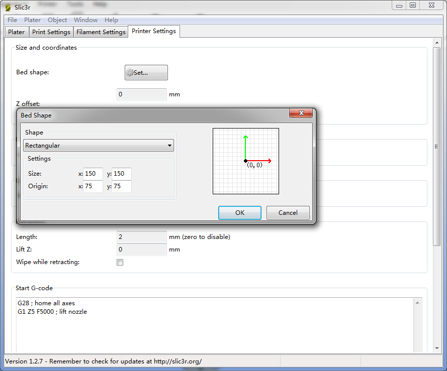

I have purchased and assembled a Geeetech Prusa I3X. During first test and calibrations one question arised:
- how do I set the center position (X, Y) in my printer so that the printing job is centered in building plate?
This is what happens now (X representing center point):

you mean like this ?

Than you Mark so much - this the case! Solution seems to be very simple - even for a newbie like me :-)

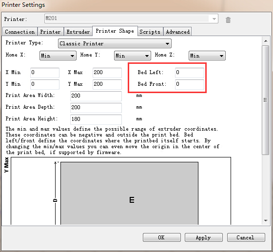

Mark, where is that screen? In printer settings or Slic3r config? I have looked around and cannot find it. My pro C prints to the right enough that the extruder smacks the Z axis if I dont move the object over to the left.

this is in the slic3r settings in repetier host 1.6.0. And how about adjust the settings here:

Thanks!
