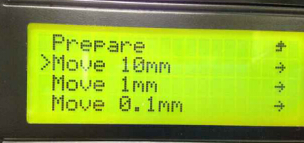

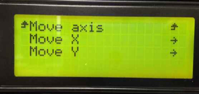

Post by Mark »
Can you show some pics about the LCD for me?
"the axis can be controled from both LCD and Repetier.The Extruder can be commanded only from Repetier.'
When I choose move 10mm, there is no extruer for me too.see the pic below:
