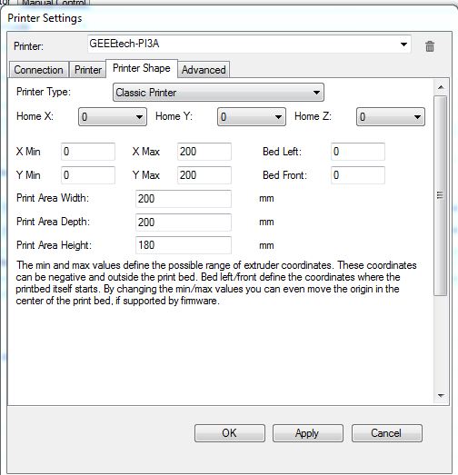

this is my configuration settings
The printing not in the center too
slicer setting.JPG (34.38 KiB) Viewed 19149 times
printer settings.JPG (51.14 KiB) Viewed 19149 times

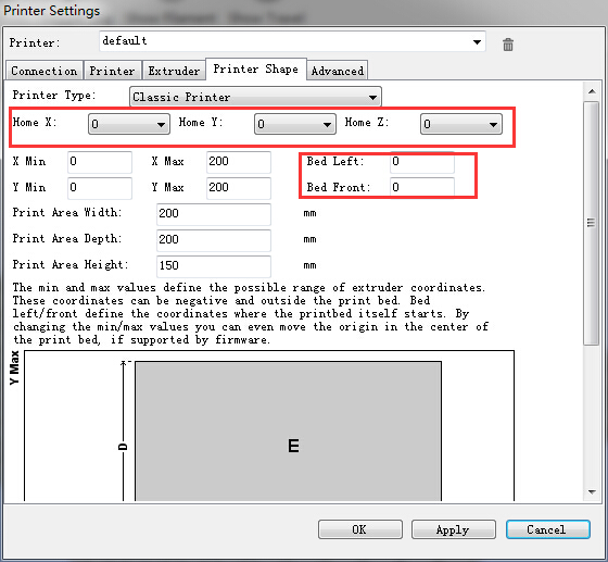

Does the nozzle in the lower left of your bed after homing?
If not, you can adjust the two settings "BED Left" " BED Front" to see if it works.
