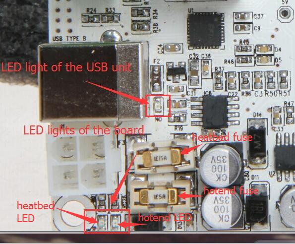

2.1 Check the board power

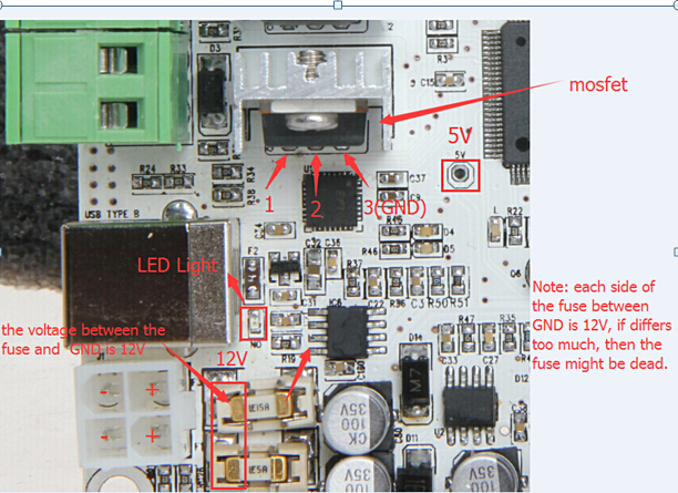

With the board powered on, the lower left LED lights will light up. If not, then check the fuse on the board. You can measure the voltage of the two sides of the fuse, if there is a big difference then the fuse is dead.
For GT2560, board power usually is 12V, and 5V for the mainchip.

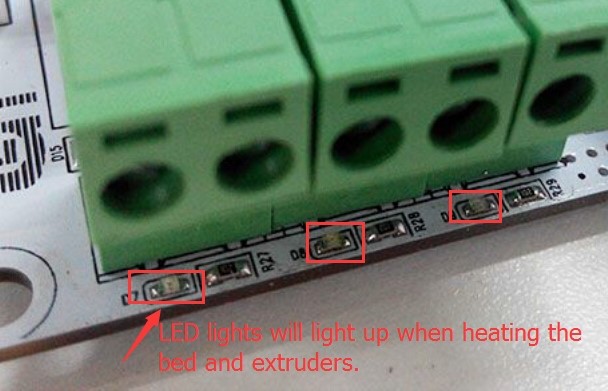

Manually heat up the hotbed and extruders, if the LED lights under the hotbed and extruder slots all lighted up, then the mosfet that controls the heating is good.
If not, the mosfet might be dead. You can check the mosfet as follows:

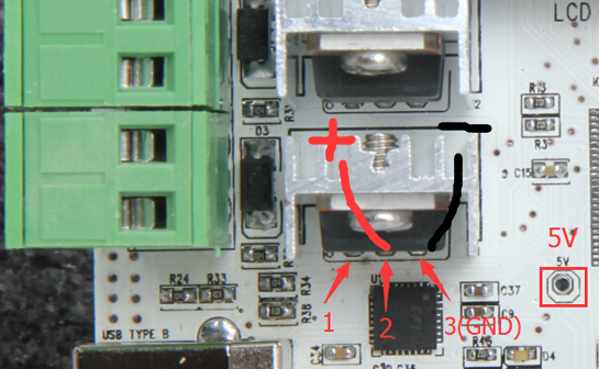

For GT2560, use the multimeter to measure the voltage between pin 2 and pin 3 of the mosfet, when heated up it is 0V,and when not it is 12V.

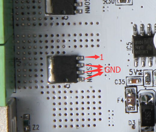

For GTM32, measure the voltage between the pin1 and any of the other pins(GND), when heated up it is 0V and when not it is 24V.

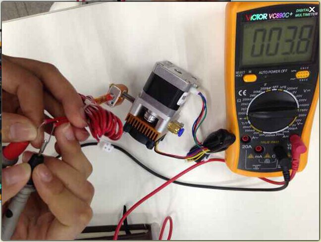

2.3 Check the resistance of the heating cartridge and hotbed
Measure the resistance of the heating cartridge and hotbed.

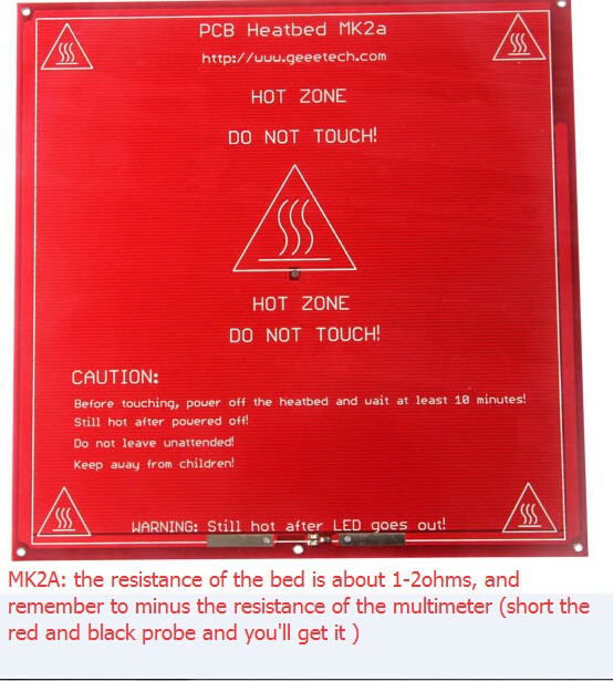

For GT2560:
The resistance of the hotbed ranges from 1-2ohms. When shorted out it is less than 1ohms and when open circuit it is infinite.
The resistance of the heating cartridge is about 3.6ohms. Also when shorted out it is less than 2ohms and when open circuit it is infinite. If there is a short circuit or open circuit, check the wiring or the component itself. You can also use a good one to verify it. Measure the resistance as follows.
Note: For GTM32, cause the mainpower is 24V, so the resistance of the heatbed should be about 5ohms and 12.1ohms for the heating cartridge.
Measure the resistance of heater.
1)unplug heating wire from mainboard.
2)turn the multimeter to Ω.
3)put the red probe of multimeter on one end of heating wire ,put black probe on another end.please let probe tips touch metal carbonyl conducting layer inside insulation material.

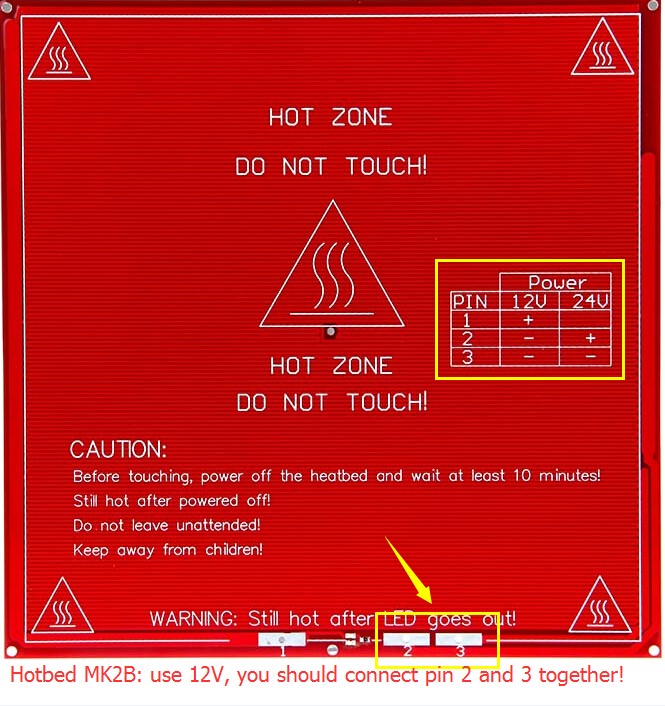

Measure the resistance of hotbed.

The cold resistance of the 12 V bed should be between 1.00 and 1.20 ohms (NOT 1-2 Ohms) beds with higher ohms are not to specification and will not heat to 110 deg or take a long time with a required overhead 120 deg Max.
To get a accurate measure of resistance of the bed's element both Voltage and Current readings should be taken across the element directly and at the same time using two meters whilst the element temperature is low as resistance rises (ie current falls) with increasing temperature.
A simple multimeter direct reading will be low for such a low ohms components as this.

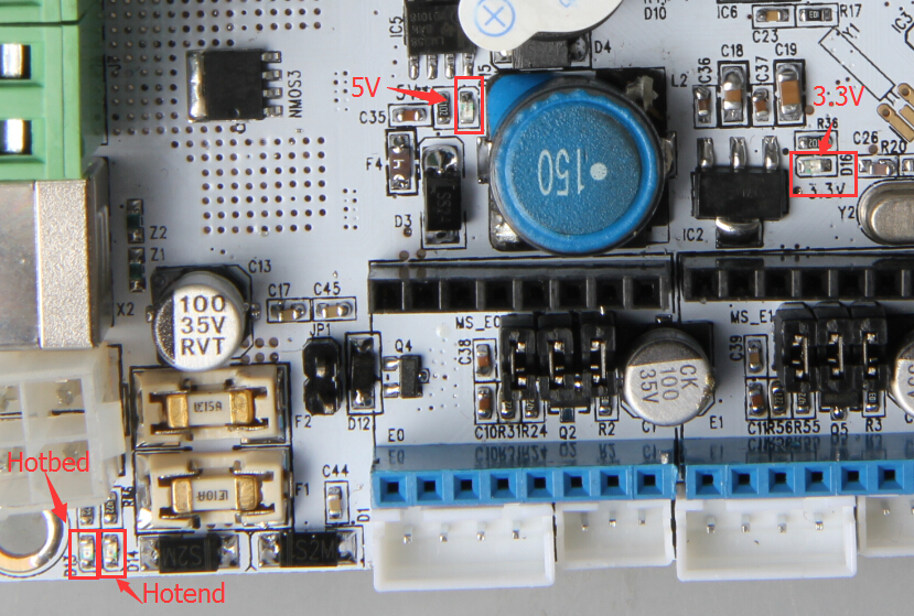

I checked again and noticed that a component on the chip is damaged (see pic).I checked the gt2560 circuit diagram, but couldn´t find anything labeled Q4. Might be a circuit breaker? Any idea´s? Also i don´t know if this component cuaused the overload or the overload caused this thing to fail... Anyway, if anybody knows what kind of component this is and if it´s fixable, I will be thankfull for any help. Meanwhile i think I better order a new gt2560 ;)
