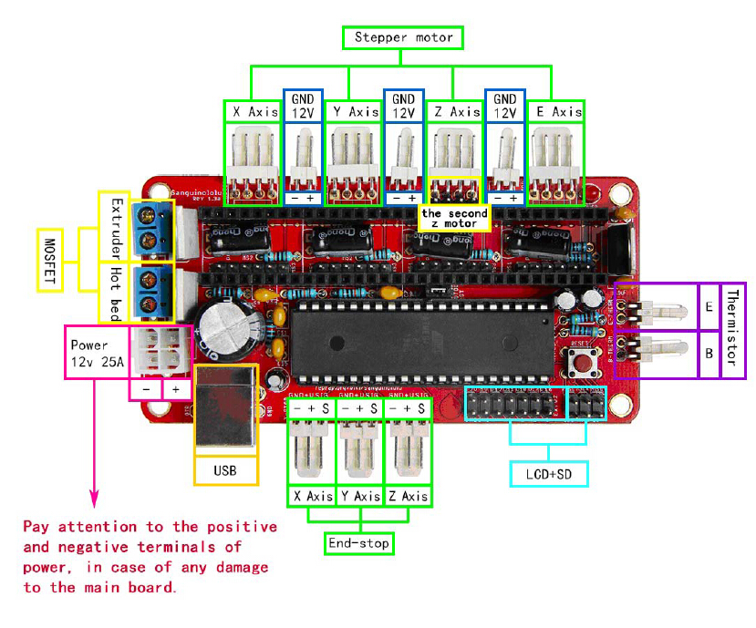

Dear forum,
I received me ducer printer and some power cables are out of controller board, which caused the motor dont working. Is somewhere possible to get on which pins are motors connected that i can put them back?
I need simply layout scheme on which pins is what connected that i can quickly fix it.
Thank you.

check this picture here:

Thank you!!!
You are the best guys!
