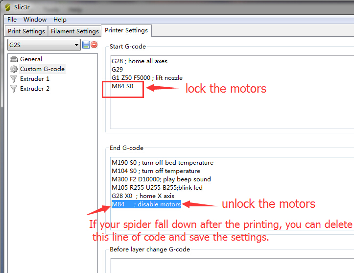

I have just built the G2S Pro Rostock delta printer. I have been able to tune it enough to get reasonable prints from it. The problem I seem to be having is that when the last G-Code command gets sent from Repetier-Host software the stepper motors are all disabled which causes the hot end to fall from the Home position down onto the part if I am not right there to catch it.
I am running Repetier-Host 1.5.6 with Slic3r 1.2.9.
Things that I have tried so far.
I removed the M84 command from the End G-Code in Slic3r.
I changed the Default_Stepper_Time from 60 to 0 in Marlin Configuration_adv.h.
I would like to keep the X,Y and Z steppers Enabled to prevent the hot end from falling.
Has anyone else seen this problem? What was your fix?
Thank you
David Cooper
Re: G2S Pro Stepper disable problem
Posted: Tue Nov 10, 2015 4:04 pm
by Mark
you need to delete the code here:

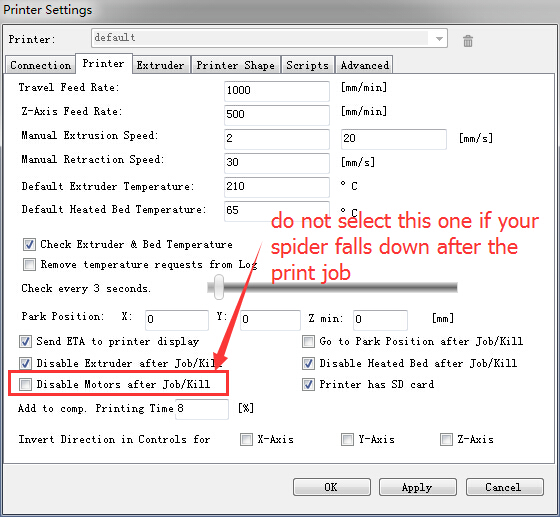

And do not select the option here:

Mark:
Thank you. The last item - Unchecking the Disable Motors after Job/Kill was the one that fixed my problem. I don't know how I missed that one!

This still doesn't work for me having completed all the following
Posted: Tue Oct 17, 2017 2:17 pm
by William
I think the end-code should be HOME all axis but not home x-axis. So you should modify the G28 X0 to G28 in the end G-code.
