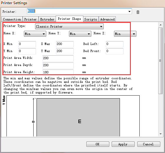

the Y axis, is your printer settings correct?

Isn't the heatbed 150 by 150? I have addressed the Y axis problem which is due to a disconnected endstop.

If your printer is prusa I3, then I remember it is 200*200.
