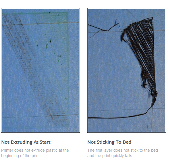

Hello guys, have you ever run into those bad printings? Now let's check the list here, there're the most common 3D printing issues and you can find the solution to solve them.
Best of all, the website is so great that they use a large collection of real-world images to make each issue easy to identify when examining your own 3D printed parts.

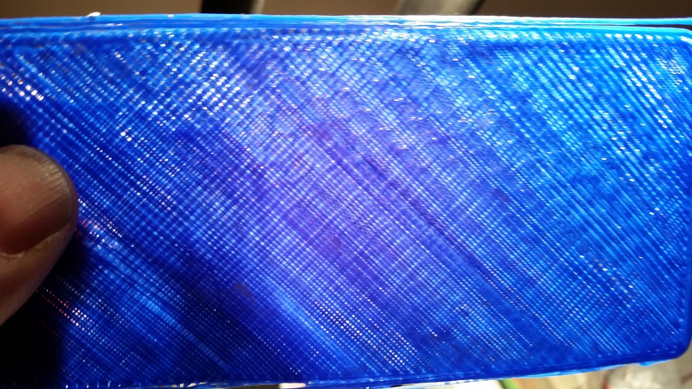

I am trying to improve my printing...
it is like the density of the printout is not dense enough.
... to much space between the threads.
I am using slic3r 1. 2.9 , but do not find how to increase this "resolution".
Should I change the nozzle ? My unit was shipped with a .4 nozzle I believe.

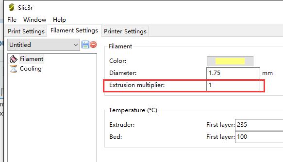

seems like your nozzle diameter is not correct, are you sure it is a 0.4 mm one? and you need to set it in both of the slic3r and printer settings.
Also, maybe the setting "extrusion multiplier" under the Filament settings will help:

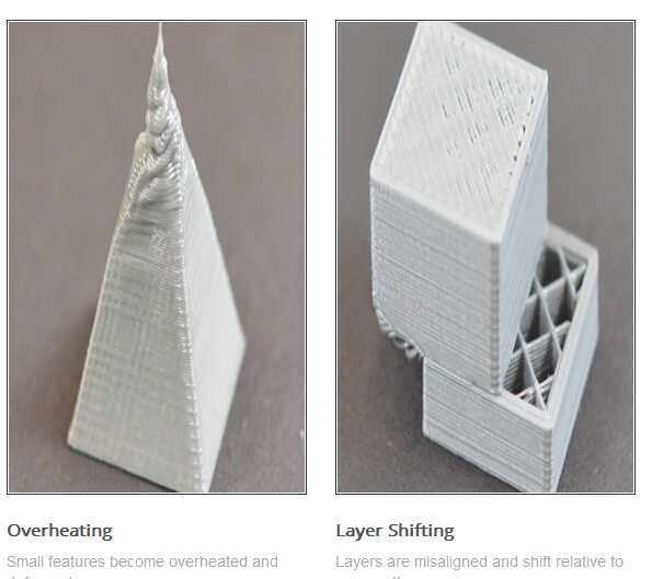

I experienced once on over heating. :( Thank you its such a big help.

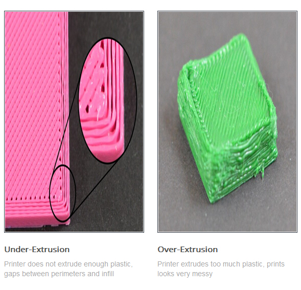

Hi all :)
It's been a week since I bought this printer and my first job was to print an M6 bolt threated but, unfortunatelly, seems not good about details :(
In facts, the steel nut, doesn't fit properly. IMHO, theese details are very importants to appreciate any 3d printer, like, also, some gears :)
What are your impressions for theese jobs? Can I hope for better?

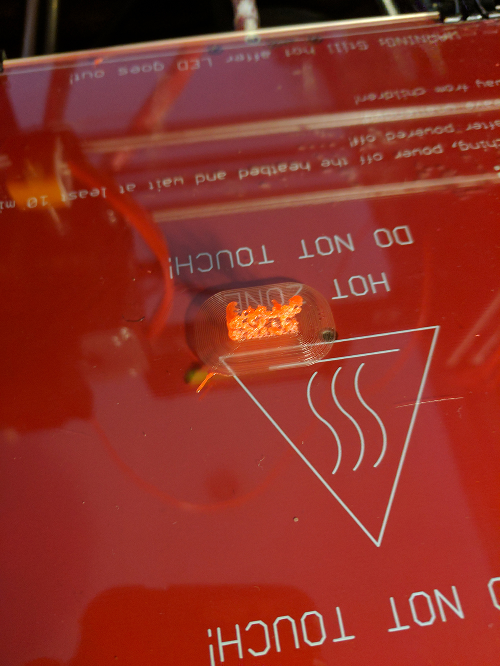

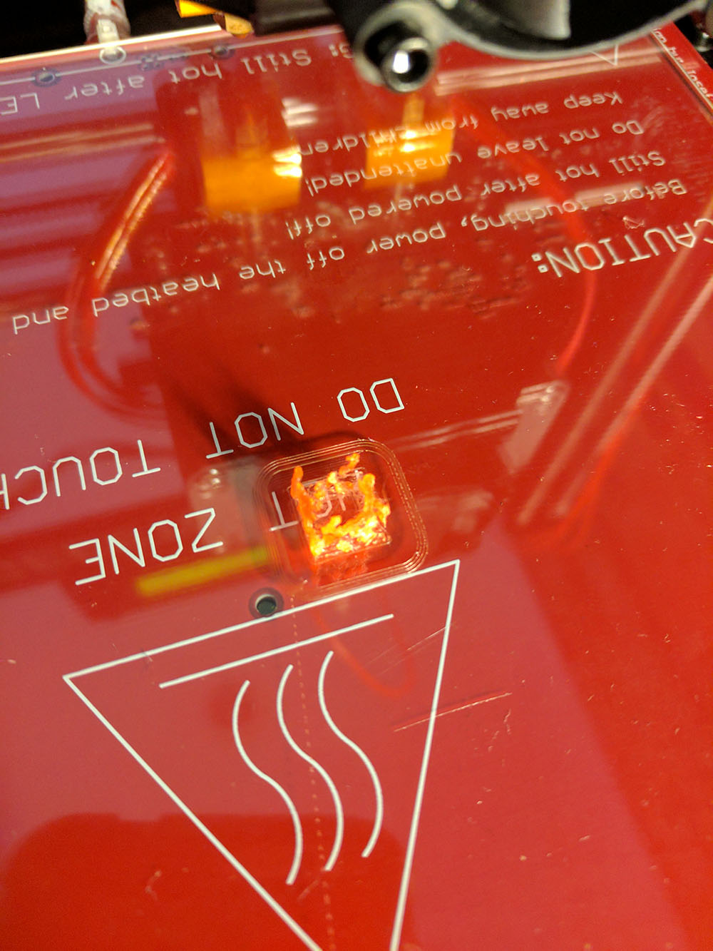

I have a I3 pro C that i havent been able to get any prints from it till now
this is mostly what im getting (see images)seems that it does not feed enough material.
the bed is set to 60 and the extruder to 200 degrees.
the extruder came without one ofthe white tubes that you feed the filemant in and thats the one printed this objects,
No 1 is a PEZ , no 2 is a cube with a hole in it.
any hints
