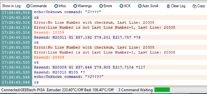

1. I plugged into my USB port on my laptop, but could not send anything to the printer via repetier-host. I got messages "10 commands waiting, 19 commands waiting" etc.

what's your printer type? I3 X or pro? the command waiting thing, I think it must be a wrong firmware or the baud rate is wrongly setted, you can reinstall the firmware to check it, and check the baud rate in printer settings and firmware both.

I noticed repetier-host had 9600 baud set, so I changed that to 250000 and it was communicating again.
will look at the other thread now and see if it applies. Thanks for the quick response.

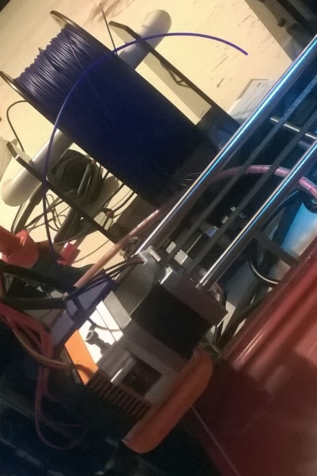

1. The roll of filament that came with the printer keeps breaking, not sure why it does that but as it's printing it will just snap and its a clean break, not like its rubbing anywhere, usually a good 10 inches from the top of the extruder.
break in filament
break in filament

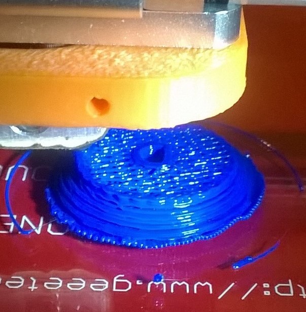

2. I have yet to get a 100% complete print job and I'm not sure why. I took a pic this time, and I got a snippet of the repetier-host software output when it stopped.
stopped print job
stopped print job
3. Here's the snippet from Repetier-host.
repetier-host output

uh...maybe it's quality is not that good, you can manually bend it see if will break easily.
as for question two, could you give me your stl files to print it with my printer see if it happens or not.

Yes, it snaps fairly easily. :-S It's the roll that came with the printer when I bought it. I'll have to buy a better quality brand.

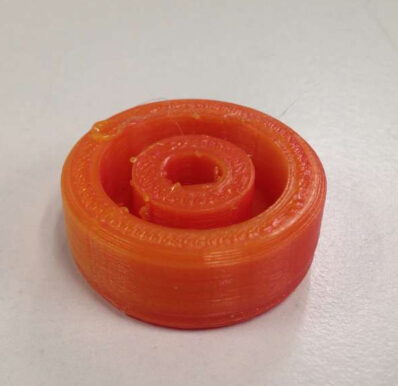

I can print your stl with good result(no need to repaire), and I noticed your temperture for hotbed is 110, for hotend is 200? If you use PLA, then hotend is about 195-210, hotbed is about 60-70.
You can use my settings to print it, and I'll attach the gcode for you too. And your print quality seems not a cylinder, the bottom is melted ...
