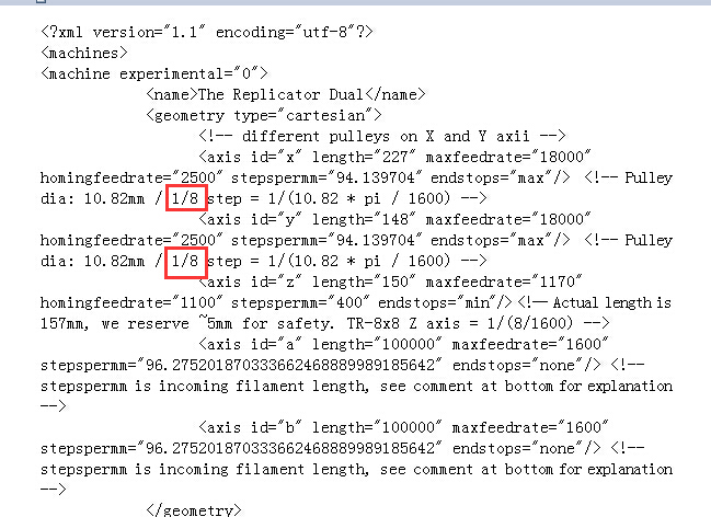

I installed a new Mightyboard Rev G and five 5 A4988 stepper drivers in my Makerbot 1 Dual. I confirm all the axis work under manual control. When I go to level the table, the extruders are driven into both the Y-axis and X-Axis positive end-stops. They are travelling too far. My theory is that the Mighty Board firmware is set up for micro-stepping and the A4988 drivers are not. Does this sound like the problem? If it is how do I make the drivers micro-step? Or is there a setting in the firmware I can change?

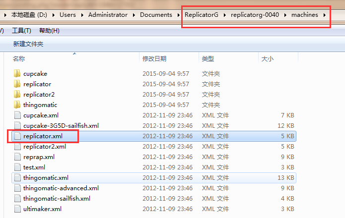

how about change the subdivision here, could this work?
